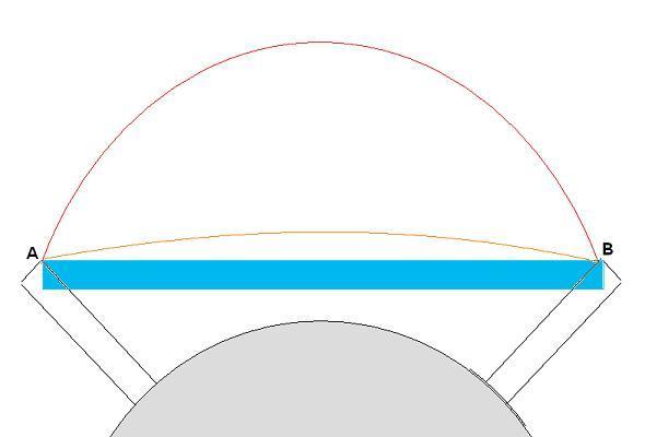

A lot depends on what you mean by straight and curved paths. Take a look at the attached sketch of two unfeasibly tall towers on the surface of the Earth. The curved red path is the path of projectile traveling between tower A and B. Since the projectile is in freefall between launch and landing, it experiences no proper acceleration and so this path is considered straight in GR. The orange curve is the path of a laser beam. The blue sky bridge is constructed far out in flat space and designed to be as straight as possible. Stress sensors are placed all over the sky bridge so that any deformations can be detected and then it is put in place between the two towers and supported in such a way that it is not deformed. The blue path might be considered straight in Newtonian physics (or geometrically straight in Euclidean geometry) but an object traveling along the blue path experiences proper acceleration due to gravity and so this path is considered curved in GR. (As a side note, a trolley at A on the blue bridge would accelerate towards the centre of the bridge before decelerating gradually to a stop at B, under the influence of gravity alone.) In other words, the definitions of straight and curved in Euclidean geometry and GR and almost exactly opposite to each other. Which definition are you using?

They will only follow the same geodesic as light if they travel at the speed of light. The path is speed dependent.

Then, on top of these traditional "forces", we have "curved space", the much maligned bowling ball image, that explains the effects of gamma. We can see some of the potential for confusion here - if an object if following a spatial geodesic (the spatial path of shortest possible distance) but space itself is curved, does it experience a "force" or not? And how do we calculate it's momentum? I won't attempt to answer such confusions except to say that if you really want to understand how it all fits together, it's a good idea and easier in the long run to abandon the notions of "gravitaitonal forces" altogether and express EVERYTHING in terms of "space time curvature".
When one does this, one explains all the effects by the same metaphor. The hybrid metaphor approach attempts to combine two different metaphors for how gravity works, making it a bit unsatisfying. But I think it still might be helpful to some readers.
A second point I'm trying to make is that we may not even have to get into the complexities of curved space to get an answer to the OP's question. Adding these complexities will give a more accurate answer, but I think even the crudest model will show that an object following the spatial path of a light beam (but slower!) will have a nonzero proper acceleration as measured by an onboard accelerometer.
Going back to definitions, for the mathemeticians among us I'll point out that what I mean by the "following the path of a light beam" is following the same spatial path (excluding time), and that to define this path, we need to slice space-time into space-time slices. I assume we have a static spacetime, then we can do this slice by the usual method of making the space-like slices orthogonal to the time-like Killing vectors.
