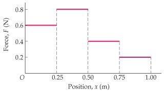

The force shown in the figure acts on a 1.7kg- object whose initial speed is 0.44m/s and initial position is x=.27m. Find the speed of the object when it is at the location x=.99m. At what location would the object's speed be 0.32m/s ?
I know that W=Fd. K=1/2mv^2. Vf^2=Vi^2+2ad.
I have no clue where to start. I am completely lost. Where do, or how do I begin? Thanks for the help!
compute the initial KE, at its initial location.
That KE is changed by the F.d , as it moves along:
(.8N)(.23m) extra as it crosses the 0.5m mark. etc.
Ok, so how does finding the Joules help me solve for velocity and location?
the KE contains all the info to find out how fast it's going. (½mv.v)
it's about KE _at_ a location , just like it used to be "velocity at a time"
Notice that they ask "where was it going slower than at 0.27m?"
