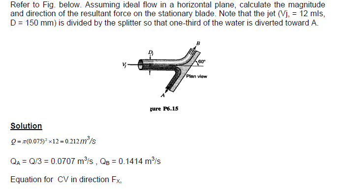

why the force at outlet A shouldn't be 0.0707(12 cos120 - 12)
as we can see from the figure , outlet A make an angle 120 with the horizontal line

I think one of your attachments ('127') is for an earlier problem.

ignore 128 , pls refer to the picture i upload now .

You are confusing yourself. Both 126 and 127 were for an earlier problem. Neither has an angle 120 degrees in it. Only 128 matches the text of your post in this thread.

sorr, pls refer to the picture i uploaded now , 129 and 126

No, the correct two images are 128 and 129.

why Fx means the force of blade acts on water ? shouldn't it be force of water act on blade?
The author has chosen to define Fx and Fy as forces from the blade acting on the water.

i mean find the resultant force acting on the pipe bend by the water , can we define Fx = resultant force acting on the pipe bend by the water instead of
resultant force acting on the water by the pipe bend ? so , if we define Fx = resultant force acting on the pipe bend by the water, then Fx = 0.0707(12cos 120 -12) +0.1414(12 cos60 -12 ) = 2.12KN(to the left)
is it correct to do so ?
i just couldn't understand why the author define Fx as resultant force acting on water by the pipe bend ?

Sure, you can define it the other way round. It just flips its sign in every equation.

Why we can't just not flip the equation and do as in the notes, but define fx as force acting on the bend by the water? I don't understand why the author define fx as force acting on the water by bend and do it this way
I can't think of a reason.
