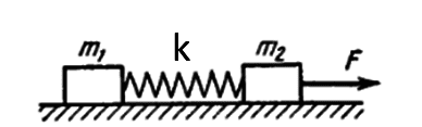

Two bars connected by a weightless spring of stiffness ##k## and length (in the non-deformed state) ##\ell_o## rest on a horizontal plane. A constant horizontal force ##F## starts acting on one of the bars as shown in the figure. Find the maximum and minimum distance between the bars during the subsequent motion of the system, if the masses of the bars are:
(a)equal
(b)equal to ##m_1## and ##m_2## and the force ##F## is applied to the bar of mass ##m_2##.
Answers:
a)##l_{max}=l_o+F/k## and ##l_{min}=l_o##
b)##l_{max}=l_0+2m_1F/(k(m_1+m_2))## and ##l_{min}=l_o##
Case a):
From energy conservation,
[tex]Fx=\frac{1}{2}kx^2+\frac{1}{2}mv_1^2+\frac{1}{2}mv_2^2[/tex]
where ##x## is the extension of the spring, ##m## is the mass of the blocks, ##v_1## and ##v_2## are the velocities of the blocks.
I still need one more equation to relate ##v_1## and ##v_2##.
Thanks!

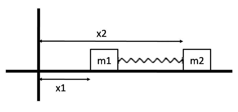

Should I replace ##a_1## with ##dv_1/dt## and ##a_2## with ##dv_2/dt##? Is the above equation correct?
Yes, your equations are correct, assuming you can express ## x ## via ##x_1, \ x_2 ## and ## l_0 ##.
##x=x_1+x_2-l_0##?
So ##a_1=d^2x_1/dt## and ##a_2=d^2x_2/dt##?
Let's say ##x_1 = 0## and ##x_2 = l_0##. Then ## x = 0 ## as one would expect - the spring is relaxed. Now let's move ##m_1## toward ##m_2##, say, by letting ## x_1 = l_0/2 ##. Then ## x = l_0/2 ##, i.e., greater than in the relaxed state, while it should be less.

I thought more about it. The best I could come up with is ##x=x_2-x_1-l_0##. Is this correct?
Also, where should I use it? :confused:
I have ##F=m_1a_1+m_2a_2## but I don't have ##x## here.

If I consider your cases (post #9), when ##x_1=0## and ##x_2=l_0##, ##x=0## i.e for this case, my equation is correct. When ##m_2## is fixed and ##m_1## is moved a distance ##l_0/2## i.e ##x_2=l_0## and ##x_1=l_0/2##, ##x=-l_0/2##, this is also correct, I can't see where my equation is wrong. :confused:
I am not saying anything is incorrect. I am saying that I would like you to check whether your equations in #6 are consistent with the your definition of x.
