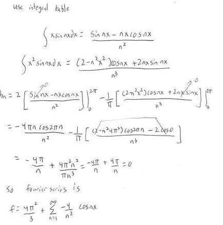

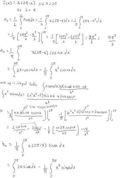

Fourier transform - would appreciate if my answer can be checked
memorex88
Question: Find the Fourier series for
f(x) = x(2π-x) 0<x<2π f(x) = f(x+2π)hope the pi is clear as π
this is in the attachments
The constant term should be ##2\pi^2/3##, but other than that, your answer looks fine.
One easy way to check your answer is to simply plot the series using a computer.
By the way, you're finding a Fourier series, not a Fourier transform, which is a different but related concept.
Thanks Vela for checking, oops been doing both topics lately, slip of the tongue
