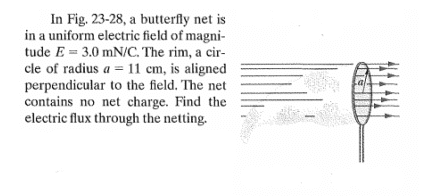

In Fig. 23-28, a butterfly net is in a uniform electric field of magnitude E = 3.0 mN/C. The rim, a circle of radius a = 11 cm, is aligned perpendicular to the field. The net contains no net charge. Find the electric flux through the netting.

My attempt is
∅ = ∫E.dA.
The direction of E is going out of the net towards +ve i axis.
I am not clear on the direction of the Area, it can be either +ve i-axis or -ve i-axis. Which direction should i consider?
∅ = ∫3.dA = 3*∫dA ---->1
∫dA is the area of the circle.
A = π * (0.11)^2 = 0.038 m2
Hence
∅ = 3*0.038 = 0.114 NC/m2. Please advise, the answer is negative of this.
The total flux through the surface consisting of the net and the circular face, taking the area vectors to point out of the surface (i.e. positive flux ##\implies## field lines leaving the surface) $$\Phi = \oint \vec{E} \cdot {d\vec{A}} = \Phi_{net} + \Phi_{circle} = \Phi_{net} + 0.003\pi a^2$$Since ##Q=0##, what must be the sign of ##\Phi_{net}##? Can you then rationalise this by considering the dot product of the area vectors with the electric field on the netting?
