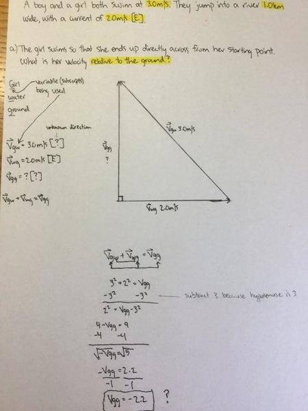

A boy and a girl both swim at 3.0m/s. They jump into a river 1.0km wide, with a current of 2.0m/s[E].
a.) The girl swims so that she ends up directly across from her starting point. What is her velocity relative to the ground?
Note: V = velocity with arrow above it.
Vgw = 3.0m/s (Girl relative to water)
Vwg = 2.0m/s[E] (water relative to ground)
Vgg = ? [?] (Girl relative to ground)
Vgw + Vwg = V[gg]
3. The attempt at a solution
I believe I've set it up correctly, although I don't see how to solve it. I know you have to the Pythagorean theorem so it's Vgg2 + 22 = 32. Which turns out to be Vgg + 4 = 9, subtract 4 on each side. Vgg = √5. So Vgg = 2.2m/s. But when looking at this equation: Vgw + Vwg = V[gg], the inner 2 w's must match, then the outer 2 letters must match, so the equation is right. But as you can see in my picture at the bottom half of the page, I get a velocity of -2.2m/s. Which doesn't exist but you can't just get rid of the negative sign, can you? How does it just go away like that? Or did I do something wrong?
You seem to have solved this using the triangle for the velocities. Or, at least you got the magnitude of the velocity. I don't undersand how you then went wrong. Using ##g## as a subscript for both "girl" and "ground" adds to the confusion.
I think it's much better in this case to think in terms of a triangle of vectors, as you did. I would have left it at that. Problem solved!

You go on using Vgg instead of its square. You did a lot of subtractions in the picture, and made a sign error ( you wrote 9 instead of -9). You calculated Vgg2 and it can not be negative.
Hi Taco,
This is a vector addition, so you can't jump from ##\vec V_{gw} + \vec V_{wg} = \vec V_{gg}## to ## V_{gw}^2 + V_{wg}^2 = V_{gg}^2 ## as you can see in the drawing you made.
Basically you should work out the addition in components, e.g. N and E :
##\vec V_{gw, \; N} + \vec V_{wg, \; N} = \vec V_{gg \; N}##
##\vec V_{gw, \; E} + \vec V_{wg, \; E} = \vec V_{gg \; E}\quad ## and apply the given info, namely
## \vec V_{wg, \; N} = 0 ## and ##\vec V_{gg \; E} = 0 ##.
The Pythagoras thingy comes into calculate ##|\vec V_{gg} |##:
$$ |\vec V_{gg} |^2 = \vec V_{gg \; E}^2 + \vec V_{gg \; N}^2 $$

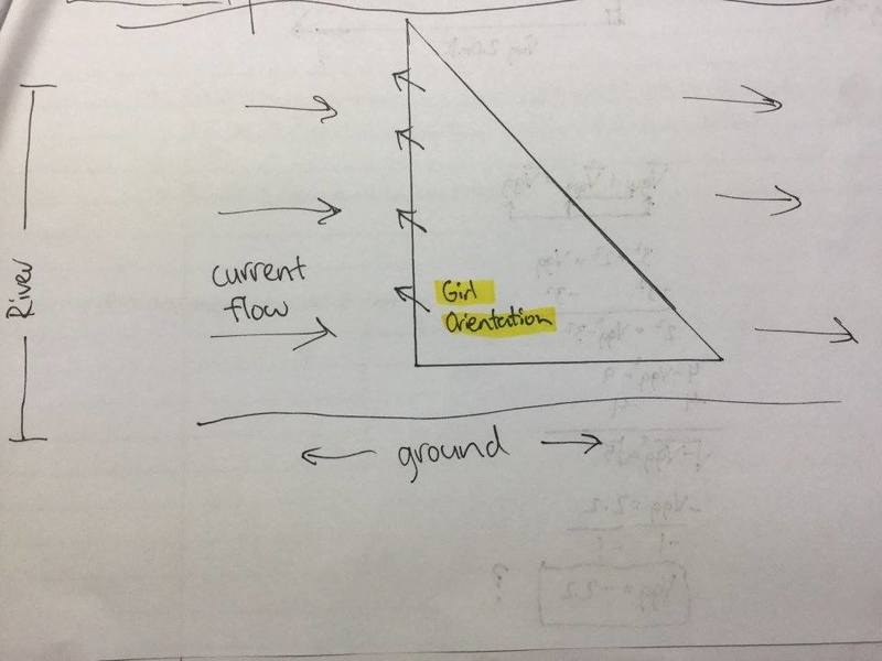

PeroK: Yeah, I know it was confusing for both g's for ground and girl but I did originally state it in parentheses so there wasn't too much trying to figure out what is what.

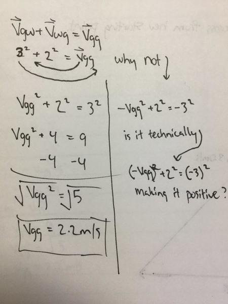

ehild: When the equation is in it's original form, you bring it over to the left side and the hypotenuse (Vgw) over the right. Why are they positive instead of negative? That's what I don't get. It may be a simple question with a simple answer, but that's what get's me on the test, and I'm trying to really understand instead of thinking I understand but make mistakes which will cost me. In the picture, the left side is correct but the right side is what I did my first try.
Edit: I posted this after BvU commented.
BvU: so basically, it's also positive? If it's the absolute value and I guess if you're finding velocity, you can solve it and take the absolute value of the answer to give you positive.
What is the sense to move over those terms, instead of isolating Vgg2? And -Vgg2 is not ( -Vgg)2 .
Well since Vgw is the hypotenuse, We can't have it stay in its original form of Vgw + Vwg = Vgg. And you can't set up the equation firstly as Vgg + Vwg = Vgw because my teacher said it must firstly be in this form; Vgw + Vwg = Vgg. You need both letters on the inner side of the left equation to match, so; Vgw + Vwg = Vgg. Then the outer two letters on the left side don't need to match. Vgw + Vwg = Vgg. (Girl is the first one then ground is the second g). Then you bring the outer two letter together from the left equation to the right side of the equation, so; Vgw + Vwg = Vgg. (Girl relative to ground). Then you have to rearrange the equation to find your answer. I hope this is making sense, please reply if it isn't.

Actually she is trying to swim in the NW direction because she is trying to swim across the river which is flowing East but she'll wash down the river going NE, so she swims NW. No need to apologize, learning takes effort :). Anyways, Vgg in my previous diagram is pointing North, we got an answer for Vgg which equals 2.2m/s. She is going straight up north and she is oriented NE to flow directly across where she wants to go. I think I understand what you are saying, I drew a picture and tell me if this is your thoughts. I didn't label anything because Vgg I wasn't sure where you might of thought it would've been on the triangle.

Your picture is correct, only your derivation was wrong. ##\vec V_{gg} ##, the girl's velocity with respect to the ground is the "north" leg of the right triangle. Applying Pythagoras's Vgg2+22=32. You can subtract 4 from both sides, and you get Vgg2=5. So the speed is √5 and the direction follows from the text of the problem: across the river, perpendicular to the river flow. I do not understand what your teacher said.
Alright, thanks. I'm still new to this but I think I understand it more than I did before. :)
