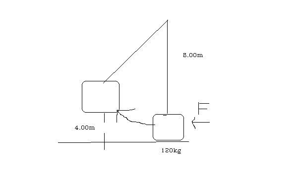

A mail bag with a mass 120kg is suspended by a vertical rope 8.0m long.
a.) What horizontal force is necessary to hold the bag in a position displaced sideways 4.0m from its initial position?
b.) How much work is done by the worker in moving the bag to this position?
K1 + U1 + W_{other} = K2 + U2
i don't understand the problem but here's what i drew so far... can u tell me if this correct
1/2(mvi^2) + mgy + F x d = 1/2(mvf^2) + mgyf
stuck here
For part a) use a free body diagram... use sum of forces = 0 at equilibrium, to calculate this force...
For part b) use conservation of energy... but remember that the bag is at rest at the beginning and at the end of the process of moving, so no kinetic energy. work done is just final energy - initial energy

i think Fgrav is the only force to be moved
b.) W = mgy2 - mgy1
= (120kg)(9.8m/s^2)(-4.0m) - (120kg)(9.8m/s^2)(-8.0m)
= 4704J
Part b is right. But part a isn't. You need to consider 3 forces... the horizontal force F, gravity and tension in the rope. The tension has a vertical and horizontal component.
If you do sum Fy = 0, and sum Fx = 0, you should be able to solve for F. You have two equations with two unknowns (tension and F).

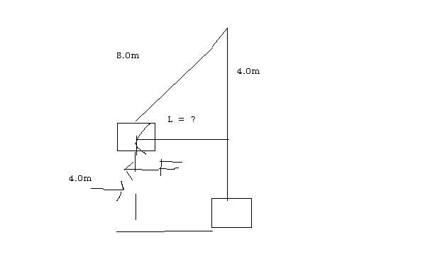

a.)
tension has a vertical and horizontal component:
using pythagoras
L = sqrt (8^2 - 4^2)
L = 6.92820m
F x L = W
since W = 4709J
F = (4709J) / (6.92820m)
F = 678.9639N < --- horizontal component
yeah i know that because this is part a when you don't know the work...
but this is all i got
what do you think?

You've done the 4m wrong. It says displacement SIDEWAYS.
That means that the Triangle (relative to the top angle) is:
Hyp = 8m
Opp = 4m
Adj = sqrt( 8^2 - 4^2 )
= sqrt (64 - 16)
= sqrt (48)
~ 7
Also, if you had looked, 4^2 + 4^2 =/= 8^2

I apologize Eduardo, BlackWyvern is right. The question says 4m displaced sideways...
So using pyth. theorem... sqrt(8^2 - 4^2) = sqrt(48) = 6.928
so y2 = -6.928 m. y1=-8.0m. So that's what you need to use for part b. so I'm getting mgy2 - mgy1 = 1260.4J
Part a), is still wrong method wise (I'm getting the same number as you, but this is just coincidence I think)... don't use work for part a)... use sum of forces...
for part a),
[tex]Tsin\theta - mg = 0[/tex] (that's the y direction)
[tex]Tcos\theta - F = 0[/tex] (that's the x direction).
Solve for F. Coincidentally I'm getting F = 678. 9639N...
