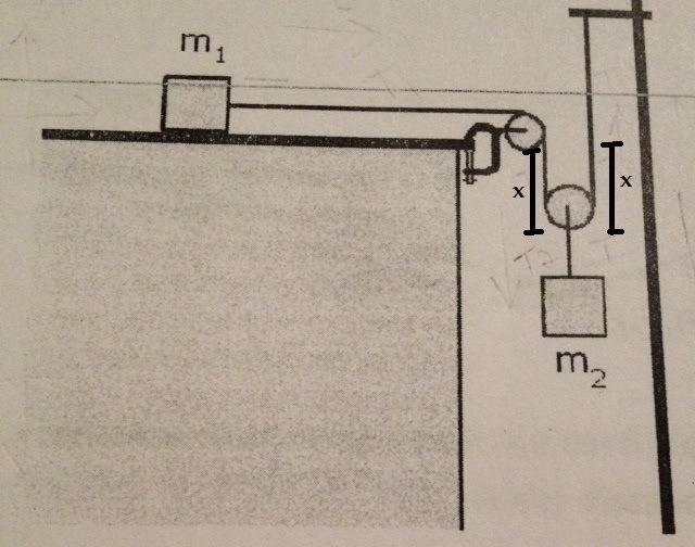

Find the acceleration of the hanging block

I thought you may not be au fait with pulleys, that's why I'm encouraging you to construct something similar to the arrangement you are analysing, so that you discover something new here. Anchor one end of the string to a nail in the wall, and tie the other end to a book lying on your table. Hang the string over the edge of the table, and hold a small round bottle or just a pencil in the loop of the hanging string so it serves the purpose of the lower pulley hanging in the rope. When you make the book slide 10cm along the tabletop towards the edge, how many cm does this cause the lower "pulley" sink?

Your two equations are right but your last eq. is not correct.
There two many 'T's floating around. And also there are two tension as there are two strings.
I think this figure will make you clear
Now can you find relation between ##T_{1}## and ##T_{2}##?

So for pulley
There is ##2T_{1}## is acting in upward direction and ##T_{2}## is acting in downward direction.
So ##2T_{1}-T_{2}=0##
So ##2T_{1}=T_{2}##
Now you need to find relation between ##a_{1}## and ##a_{2}##.

I have labelled the three parts of the string (let it's length be ##l##).
From the figure
##x+2z+y=l##
If you differentiate this equation with respect to time (two times) you will get the relation between ##a_{1}## and ##a_{2}##.

Do you know that ##\frac{dx}{dt}=v## and ##\frac{dv}{dt}=a##
Any way, can you tell me if you pull ##m_{2}## by ##x## then how much distance will ##m_{1}## covers?

No.
I think I lead you on a wrong path. Sorry for that.:s
If m2 is pulled by 'x' distance then m1 is pulled by '2x' distance.
So ##a_{1}=2a_{2}##.
Just use this value and find the answer.

Correct. Go ahead.
  • #56
4m1a2-m2g=-m2a2
a2=m2g/(4m1+m2)
