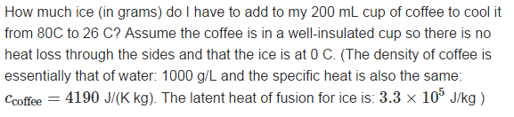

Q = Lm (L is latent heat of fusion)
Q = c m ΔT (c is specific heat) (m is mass)
[/B]
equating the 2 equations : Lm = c m ΔT
the m's cancel out
L = c ΔT
feels like something went wrong at this point
You will need to take into account that the ice will continue to cool the coffee after melting. What will be the relation which tells you how much heat is released when the ice melts and gains 26 °C?

Q = L m
so for example
(1 kg of ice ) ( 3.3x105 J/kg) = 3.3 x 105 Joules

No, this is the heat required when melting the ice only. The ice will also need to be heated to 26 °C.

So what is the total heat required to melt the ice and heat it to 26 °C?
ok, so we have 200 mL of coffee = 0.2 L
density of coffee is 1000 g/L
1000 = m / 0.2
m = 200 g of coffee = .2 kg
heat required to change coffee temperature from 80C to 26 C is:
Q = c m ΔT =( 4190 ) ( .2 kg ) ( 26 C-80 C)
= -45252 joules
so amount of ice i need is
Q = L m
45252 = 3.3x105 m
m = 0.137 kg of ice
correct?
Q = L m
45252 = 3.3x105 m
m = 0.137 kg of ice
correct?
No, the ice is in the coffee so you will also need to heat it from 0 °C to 26 °C in order for the coffee (and ice, which is now water) to have a temperature of 26 °C. This requires more heat than simply melting the ice.

No, the ice is already at the melting point. After melting, it is water.

If you put the amount of ice you quoted, you will end up with coffee at 26 °C mixed with water at 0 °C. The resulting mixture will obtain a temperature in between.
oooh, so we actually didn't need that much ice. k, let me do some thinking

This is now the heat required to heat up the water (previously ice) to 26 °C. So what is the heat required to melt the ice and then heat the resulting water to 26 °C? This must be equal to the heat released when cooling the coffee down to 26 °C.

As I said, you do not need the specific heat of ice, it is already at melting temperature and after melting it will be water.
You are also again neglecting the heat required to actually melt the ice. You must consider both the melting heat and the heat required to heat the resulting water at the same time.

No, but you do not need to change the temperature to melt it. You need to supply the melting heat. Then you need to raise the temperature of the water by 26 degrees.
I am sorry, but I cannot say it in more ways: You need to take two contributions into account, the heat required to melt the ice and the heat required to heat up the resulting water.
ok , bear with me , so we know the water releases 45252 joules
so the heat required to melt the ice + the heal required to heat up the melted ice to 26 C = 45252
and heat required to melt the ice is Q1 = (mice) (3.3 x 105)
and heat required to heat up the melted ice to 26 C is Q = 4190 mice 26C
[(mice) (3.3x105 )] + [ (4190)(mice) (26)] = 45252
factoring out the m in for left side
m [(3.3x105 ) + (4190)(26C)] = 45252
m = .103 kg
correct?
Correct, now you need to find a function which describes this as a function of the mass of ice.

Correct with the caveat that your middle steps should show some units. :rolleyes:
