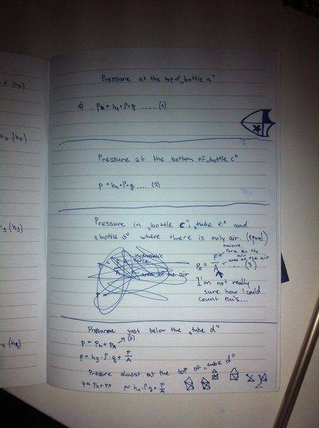

I wrote this down and I'm not sure where are we heading.
At the top of the "bottle a" ph= h1*ρ*g = 0 (because the height is 0)
down the bottom of the "bottle a" ph = h2*ρ*g
at the bottom of "bottle c" [p][/h] = h3*ρ*g
I could go on (I have it on paper right next to me)
I feel stupid. I don't get how this could help me. (or where did I go wrong?)

I cannot check that because you have not defined those heights. Can you post a diagram with heights or reference points marked?
Remember that the tubes containing air make some pressures equal. Your aim is to find the pressure near the top of tube d.

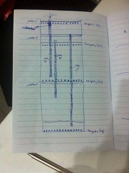

I'm now not at home, sorry for not replying so long. I have it written on a paper, because it's almost impossible to write on my very old IPhone. I attached the photos here.
I think I must've made a mistake somewhere but I'm not sure where.
I can read the diagram, but I do not follow the working.
The first hurdle is to realize which heights are relevant. There are five types of level in the set up:
  • Top of container
  • Top surface of water
  • Bottom of container
  • Top of tube
  • Bottom of tube
Clearly not all are relevant. Start with the type that is most clearly relevant and see how far you can get with that type only. Hint: very few of the types are relevant.

Call the surface heights in the three bottles A, B, C. What is the pressure at C?

You know the pressure at A, and there is a continuous body of water from there, down through tube f, into bottle c, and back to surface C. In terms of those heights, what is the pressure at C?

Okay so we have:
Pressure at A -
P = h1ρg + Pa = 0+Pa
Pressure at B -
P = h2ρg + Pa
Pressure at C -
P = h3ρg + Pa
Dami121 said:
Pressure at B -
P = h2ρg + Pa
How do you get that? What connects the contents of bottles B and C?

Next, what is the pressure inside tube d at A? Look at what connects this to B.
  • #32
The tube is full of water, so I think the pressure in tube d at A would be
P = h1ρg+h3ρg ?
Of course the pressure changes there, but the initial pressure from the air in bottle B remains the same in the whole liquid no?

But let me try at least, since the height A is smaller than height B I guess the pressure in the tube d at A must be smaller than at B.
Then the pressure at A in the tube would be:
P = h3ρg-(h2-h1)ρg ?
  • #35
To be clear, the way you are using h1 ... h3 they are depths from the top, not heights from the bottom. So you mean that the depth at A is less than the depth at B.
Yes.
P = h3ρg-(h2-h1)ρg
Yes.
So what is the pressure difference between inside the tube and outside the tube at A?
How does that pressure difference relate to the height of the fountain?
