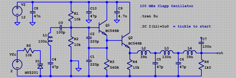

You do not need a varicap to check this circuit. Just use a fixed capacitor, then you can step that parameter value.
Some oscillators won't, because of the numerical stability and the perfection of the SPICE model, so it takes a kick to get them going. Sometimes a big kick will give some idea of where the losses are and why it is so dead.
At other times only the smallest tickle is needed which is the case with this Clapp oscillator SPICE model. One solution is to set a starting current of say 1 uA in the first tuned circuit by using an initial conditions statement, for example;

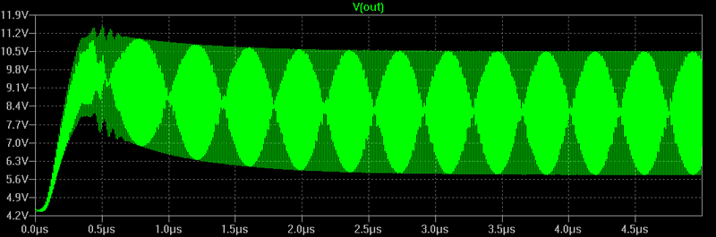

.IC I(L1)=1u0
This circuit may start without a tickle, it depends on your partricular simulation parameters. Frequency is about 100 MHz.
The pattern is a beat between the pixel pitch and the 100 MHz sinewave.
Two LTspice files attached, remove the .txt extension to run.

michael1978 said:
how you did please, how you find the corrected transistor and varicap,
I did NOT find the right components, I just made it work well enough to test. I could make the components if I needed them.
I selected the transistors because they will work in that application at 100MHz, they are not optimum.
I did not try to model the varicap as it is not needed to test the design.There are only two varactors in the Ltspice standard library. It is there on the diagram as a "place-holder".
There are many sources of extra models for LTspice. You can edit components from other versions of spice.

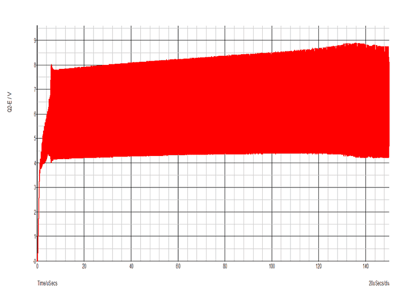

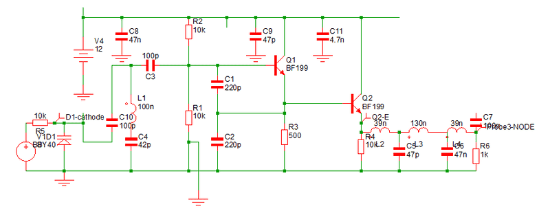

Hello sir, i find good software, and i have gratis version 7.2 intro,, if you want i can send you...
sorry i make you tired, i make the same like your circuits i just change the transistor bfg520/PS
I configure SEE THE PICTURE
I change the resistor to bf199 and i get this(the same configuration)

It is hard to read your diagrams, but your C10 looks like 6.8pF. Increase that to 47pF, connected to ground. Open circuit the V3 source and run the simulation for 100usec. If it does not then start and run, you must experiment with a V3 pulse of 100mV or an initial current of maybe 100uA in L1=100nF.
Find the initial current or pulse needed to make it ring then die. That tells you the phase and gain are insufficient to sustain oscillation. Find out how sensitive it is to small changes in component values. Adjust one component at the time to make it ring at about the right frequency for a longer time. When you have sustained oscillation, reduce or remove the initial current used to initiate the oscillation during testing.

But i try to bc199, in begin let say 4sec and is about 1.4VPP is good sinus waveform, after in the middle he change the waveform in bigger plus not normal waveform like i told you, NO SIR please don't misundersand me i thougt you know because they are spice, ok sorry what i said, you said to connect to ground C10 47P, and to change L1 to 100uA and V3 where to leave it?
I suspect that the spurious oscillation comes from the emitter follower. Try it without.
I also notice that the 220pF capacitors are unusually large for 100MHz. In practice, this might cause trouble due to unwanted resonances involving the self inductance of the component.
Also, I cannot see any purpose in C3.
I have usually found that the fewer components in the oscillator circuit the better, and I especially do not like the use of a resistor in the emitter of Q1 as it is shunting the tuned circuit. I have found the Hartley circuit to require fewest components and be the most reliable.
Apologies, I realize it is a DC block.
