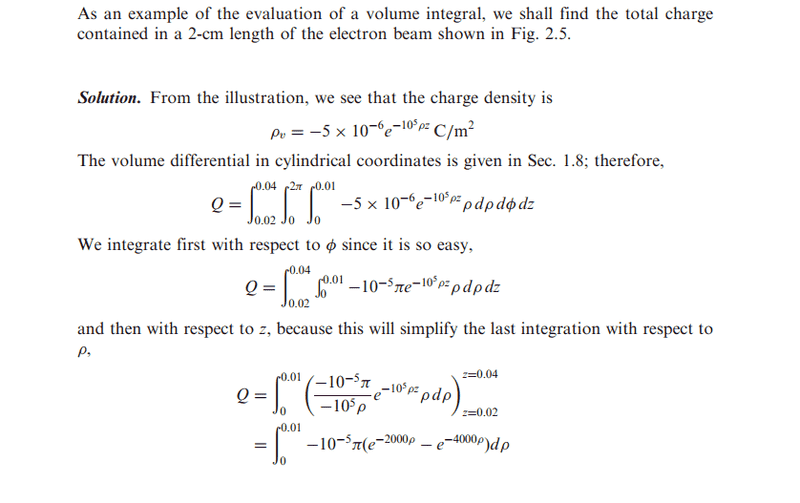

Hello guys ! :)
i need your help in the integration which is used to calculate the total charge in the electric field
in a continuous volume charge distribution
in this example i can't understand how the integration was done ..so please help me with this :)
The example :
iam not very good in integration so i need your help ...Thanks guys !
What, specifically, are you having trouble with? If you are not very good at integration, then you need to review the subject and work some practice problems.
the problem is that iam not very good at integration :( and i don't know from where should i start ..i mean which book or tutorial should i start with to help me with this type of examples ?? :)

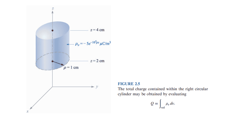

Looks to me like there's a mistake in the textbook
Blue figure gives charge as so many microcoulombs per cubic meter
and text below gives it as same number of microcoulombs per square meter.
So it's just a triple integration to get volume, but you integrate wrt z last because ρ is a f(z).
I'd solve it for volume first with ρ a constant(1?), to gain confidence in my ability to triple integrate.
Then go back and include the p(z) in the third intergral.
At least I think that's what i would do ... It's been decades.
Might be you need to go back to your calculus book. It is important to work so many problems they become second nature.
old jim
old jim
