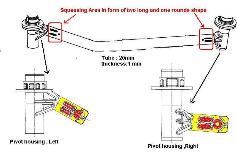

i am not a physics expert but a technical man. i encountered a problem in designing a machin for pipe pinching(squeesing) . the pipe has 20 mm diameter outside and 18 mm inside made by galvanized sheet (1.0350) with Re=140-300 N/mm2 yield strength. my machine use 3 pins for squeesing each side of pipe head( 6 pin boath sides) ( together 12 pin for boath heads). the pins are rounded and have 4.5mm diameter. i decided to use 4 hydraulic jack for four direction to push the pins to the pipe(every 3 pins are attached to shaft of a jack).
my question is what power of hydraulic jach should i use?
(please mention the formulas used for solving the problem)

first of all please accept my apologize for latency in reply.
please note to the picture:
the tube and the sqeezing area and the pivot housing which should be attached to both end side of tube are shown. the yellow part of pivot housing would be inserted in tube and the red part on pivot housing is the pressing area which should be pressed into their hole.

ahrouhi: User nucleus mentioned a good empirical method, in which you use a hydraulic cylinder with a pressure gauge attached, apply a force, then compute the applied force F, where F = p*A, p = hydraulic pressure, and A = hydraulic cylinder piston area.
But if you do not want to use an empirical method, we can only guess using an analytic method. I will talk about only the slot, for now. If your diagram is to-scale, your slot appears to be approximately 18 mm long and 6.5 mm wide. If you are pressing (into the slot) the rounded tip of only one 4.5-mm-diameter pin at a time, then I would probably apply a pin axial force of P1 = 80*Re*d1*(t^2)/a, where Re = pipe material tensile yield strength, d1 = pin diameter, t = pipe wall thickness, and a = slot width. Therefore, if Re = 140 MPa, then P1 = 80*Re*d1*(t^2)/a = 80(140 MPa)(4.5 mm)[(1.035 mm)^2]/(6.5 mm) = 8306 N. And this is if you are pressing near the center of the slot. If you are pressing near the ends of the slot, I would multiply P1 by 3.
But if Re = 300 MPa, and you are pressing near the center of the slot, then P1 = 17 800 N. If you are pressing near the ends of the slot, I would multiply P1 by 3. Keep in mind, P1 is the axial force on one pin.
Therefore, if the pipe material tensile yield strength is Re = 300 MPa, and you press near the end of a slot, a very high-strength pin material might be required (using a pin diameter of d1 = 4.5 mm), whereas if you are pressing near the center of the slot, a normal or high strength pin material could probably withstand the stress. If you are pressing with three pins per side at one time, then multiply the above force by 3.
In the above, I assumed you want to firmly press the pipe wall into the slot. If you instead want to only slightly deform the pipe wall into the slot, then the required compressive force P1 might be slightly less than estimated above.

please note to attached picture. actually the pinch bar shape is not rounded. they are in oval shape. please inform me if i want to use a pinch bar for each hole(totally 3 pinch bar), would you guide me how to calculate?

My current guess is, for each yellow pin, I would probably apply a pin axial force of P1 = 36*Re*L*(t^2)/a, where L = slot length = 18 mm, and a = slot width = 5 mm. Therefore, P1 = 36(300 MPa)(18 mm)[(1.035 mm)^2]/(5 mm) = 41 650 N. And for the red pin, I would probably apply a pin axial force of P2 = 70*Re*L*(t^2)/a = 70(300 MPa)(7.8 mm)[(1.035 mm)^2]/(8 mm) = 21 930 N. Therefore, if Re = 300 MPa, the total force for two yellow pins and one red pin would be 2*P1 + P2 = 105 230 N.
Dear NVN. i don't understand why u use 36 in p1(better to say f1) calculation and 70 in p2(f2) calculation. menwhile the L= length of yellow pin is not 18, its 10+1.5+1.5=13 and yallow pin width a=3.3 mm. am i right? or we have to calculate the slot size in formula instead of pin size.
and the same for red pin 7.8 is ok for length but for width its not 8 , it is 5.8 mm.
ahrouhi: The 36 and 70 are merely my estimates or guesses. I do not have a rigorous explanation of them, as they are my current guesses. The formulas use slot size, not pin size. Yes, change the names P1 and P2 to F1 and F2.
