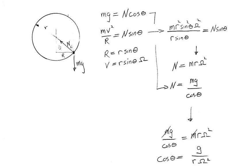

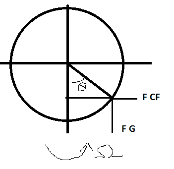

Basically i have to prove a lagrange equation using a non-inertial reference frame. A bead on a hoop where the hoop rotates as in the image below.
F = Fg + Fcf
mR(d2θ/dt2) = mΩ2Rcosθsinθ -mgsinθ
what I'm supposed to get
Fg = -mgsinθ
Fcf = m(ΩxR)xΩ = mΩ2Rcosθsinθ
I know that
Ω = Ω(0 , sinθ, cosθ)
R = R( 0 , k I'm just lost and frustrated :(
This is probably late but does this work?
