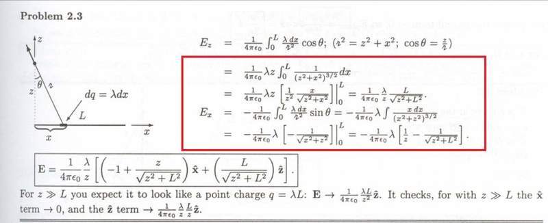

Hello, I need help solving an integral in the line charge equation for my electrodynamics class. I'm using Griffiths third edition and I understand where the components of the problem come from, but I can't seem to solve the integral, although I'm sure it's very basic. It's been awhile since I took calc 3 and I can't seem to find any similar examples online. I attached the solution to the problem and put a red box around the two integrals (Ez and Ex) that I need help understanding. Just the basic rules that were used to integrate and find the solution would be much appreciated. Thank you!

Here it is written out..
Integral of 1/[(z^2+x^2)]^(3/2) dx. How do I integrate this?
[tex]\int \frac{dx}{(x^2+z^2)^{3/2}} = \frac{x}{z^2 \sqrt{x^2+z^2}} + C[/tex]
I know the solution, but I wanted to know how to get it. What rules did you use?
trig substitution x= ztan( theta).

Alright so I tried to relearn trig sub. and attempted the problem but I'm going wrong somewhere. I scanned my work and attached it. If someone can quickly review and perhaps point out my mistake it would really mean a lot. Thanks.
If [tex]x = z \tan \theta[/tex] then [tex]dx = z \sec^2 \theta \mathbf{d \theta}[/tex]
Okay I finally figured out how to get the answer. Sorry to keep this thread going! At least I feel caught up on trigonometric substitution now. Thanks ╔(σ_σ)╝ and Inferior89.
Integrate and substitute back from [tex]\theta[/tex]
[tex]\sin ( \arctan (x/z) ) = \frac{x}{\sqrt{x^2 + z^2}}[/tex]
