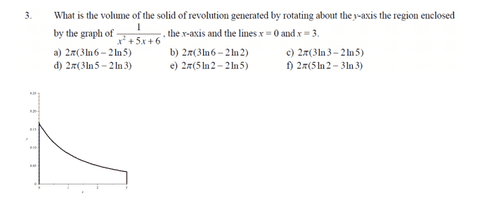

Question is attached in this post.
Disk Method with the radius equal to 1/(x^2+5x+6)
∫A/(x+2) + B/(x+2)^2 + C/(x+3) + D/(x+3)^2 from 0 to 3
I've used algebra to solve for both B and D, both of which are equal to 1, but can't seem to be able to solve for the values of A and C.
The answer to the question is 2π(5ln2 - 2ln5)

Your values for B and D are correct. How can we help you find your mistake if you don't show your work?

1=A(x+2)(x+3)^2 + B(x+3)^2 + C(x+2)^2(x+3) +D(x+2)^2
I first let x=-3, and was able to get D=1
Next I let x=-2 and was able to get B=1
However, I can't seem use this method to get the values of either A or C.

That's because [itex](x + 2)(x + 3)[/itex] vanishes when [itex]x = -3[/itex] or [itex]x = -2[/itex], so to make the coefficients of [itex]A[/itex] and [itex]C[/itex] not vanish you need to choose some other values for [itex]x[/itex].
That will leave you with two equations in two unknowns once you substitute the known values of [itex]B[/itex] and [itex]D[/itex].
Try plugging in some other values for ##x## to get more equations. Alternatively you can compare coefficients of various powers of ##x## on both sides. For example, maybe try ##x=0## or looking at the coefficient of ##x^3## on both sides.

Could you clarify exactly what you mean by comparing coefficients of various powers of x on both sides?
Also, alternatively, can I use Trig Substitution instead to solve this problem?

You have ##1=A(x+2)(x+3)^2 + B(x+3)^2 + C(x+2)^2(x+3) +D(x+2)^2##. It's pretty easy to see the coefficient of ##x^3## on the right side is ##A+C## and you have ##0x^3## on the left so ##A+C = 0##.
I don't see how trig substitution would be useful nor why you would want to try it.
