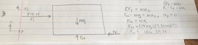

Handwritten free-body diagram of a box with downward mg, upward FN, a 215 N applied force F1 to the right, and friction FF to the left, with x-y axes and force equations on the right.
Handwritten physics work on lined paper: friction force FF = 0.1 × 186.39 N = 18.64 N, net force ΣFx = 215 N − 18.64 N = 196.36 N, momentum change mΔv = 196.36 N × 1.5 s = 294.54 Ns, and part b impulse = 215 N × 1.5 s = 322.5 Ns, with part c started.
This is where I got stuck... How can I solve for impulse without time or velocity? Is there a way to manipulate the equations to love for either time or velocity?

Hi x:
As I read the problem statement, the time to use is 1.5 seconds, and the force is calculated using FF=μFN.
Also, WRT (a), I think your teacher would like momentum in the units kg m/s.
Hope this helps.
Regards,
Buzz
