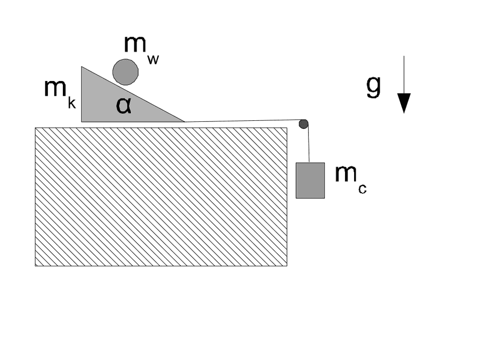

Consider the layout shown in the figure. ˙
A roller with a mass m_w and radius and moment inertia about the axis of rotational symmetry
I = ((m_w)R^2)/2 rolls without slippage and without rolling friction on an inclined plane (with an angle of inclination α) parts of the block, and the block of mass m_k moves without friction on the stationary table. The mass of the weight is m_c.
a) for the data m_k, m_c, R, α determine the mass of the cylinder
m_w, at which the cylinder can rest relative
block demo;
b) for the data m_w, m_k, R, α, determine the mass of the mass m_c at which the block may rest
to the table;
c) for (any) data m_k, R, m_w, α and
block acceleration a_k find the mass of the weight
m_c.
The acceleration due to gravity is g
a = gsina.
I = ((m_w)R^2)/2
a = m_c*g/(m_c+m_k+m_w)
