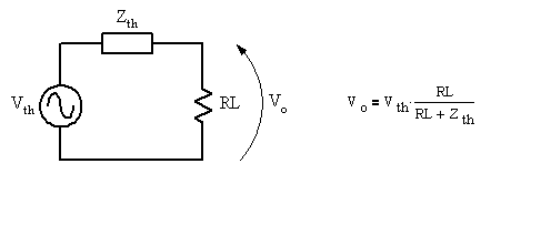

Okay, a bit of a tricky one here. Since you've got the angular frequency of the source you can determine the impedance of the capacitor. No need to go solving differential equations if you're looking for the steady-state conditions. The controlled source, being ideal, isn't going to care about the load it sees, it'll want to faithfully produce twice the voltages it sees at the top of the capacitor. So intuitively it feels like the Thevenin impedance should be zero... something to confirm by analysis.
One approach to finding Thevenin equivalents when you've got controlled sources involved is to place a load resistor RL across the output and solve for an expression for the output voltage. Now, a Thevenin equivalent with a load attached is just a source and potential divider:
If you can force your expression for the output voltage into the form of the voltage divider expression, then you can pick out the Thevenin voltage and impedance by inspection.
If the Thevenin impedance turns out to be zero then your expression for the output voltage will not contain the variable RL at all, and you'll be left with just a Thevenin voltage :wink:

I see..Say that I wanted to solve this by finding Voc/Isc.. When I short the two ports. It makes one side of the dependent voltage source = 0 (directly connected to ground)...
So how does that work? If the equation governing the top of the capacitor and the other side of the dependent source is
V2 = 3*V1,
(with V1 being the top of the capacitor, and V2 being port A)
If V2 is 0 (because it's shorted directly to the ground)... what does that make V1? 0 aswell? Or does the dependent circuit take priority, and make port a equal to 2x whatever v1 is despite being connected to ground.
http://imgur.com/ExHKGB0
Here's my working, where have I gone wrong.
A bit of an explanation of what I've done is basically considering a supernode across the dependent source, and then performing KCL on that node.
Relating V1 and V2, then solving for V1. solving for V2, and declaring V2 and my Voc.
Shorting the ports, calculating Isc (this is the part I'm least sure about). (I've assumed current going through the capacitor in the event of a short circuit across the ports is 0, as both ports of the capacitor are at 0volts.)
Then saying Zth = Voc/Isc

It looks as though you've reached the correct values, if I'm reading your work correctly.
That's the idea. If you write KVL around the second loop (output shorted) you have v1 + 2v1 = 0, which means v1 is zero. In order for v1 to be zero, the mesh current in loop 2 must be equal to the mesh current in loop 1 (that is, i2 = i1, where i1 and i2 are the mesh currents for the two loops).
