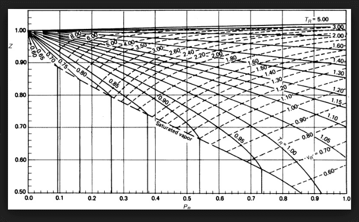

How do you find Z when the temperature line ends on the compressibility chart?

zachdr1
89
How do you find a value for Z using the compressibility chart when the temperature line you're trying to use ends?
For example, if you look at the compressibility chart and try to find a value for z with P_r = .75 and T_r = .96, you will notice that the line for T_r = .95 ends well before the pressure of .75. How do you find a value for Z in this situation?

How many phases do you have to deal with when Pr, Tr are less than 1.0?
zachdr1 said:
Why do the Tr lines stop increasing in Pr after a while?
What do you think the dashed line in the figure represents?
the psuedo reduced specific volume
edit: i just realized you meant the saturated vapor line, anything below that line isn't a saturated vapor so I am assuming you can't use Pv=ZRT?
So if I asked you what the value for Tr is at Pr= .4 and Z=.6, what would your response be? This isn't a homework question by the way I just want to know what your response would be.

0.86
