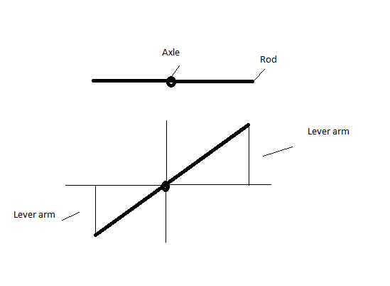

Imagine a uniform, symmetric rod, free to rotate around an axis going into the computer screen through the center of the rod. Now say that we start off the rod so that it is not horizontal or vertical, but somewhere in between. My intuition tells me that the rod will start to fall and rotate, but why does this happen? Isn't it true that by symmetry, if there is torque exerted by a particle of the rod on one side due to the force of gravity, an equal and opposite torque would be exerted by the particle the same distance on the other side of the rod, so the rod should stay stationary. But I know this isn't the case, so where am I going wrong here?
T = r*l
where r is distance and l is the lever arm
I've attached a diagram of the situation as I see it.

Is my intuition wrong? I mean, for example if I take my pencil and hold it between my fingers as close as I can to the middle the higher end starts to rotate downwards, maybe that's because the pencil is slightly unbalanced or I am not not holding the pencil exactly in the middle.

I'd say it was. I agree with your reasoning in your first post; the torques from each side will cancel.
You'll have to arrange a more careful test.

Well mystery solved, that makes a lot more sense. Thanks
That's the obvious answer. If you are balancing the pencil on one finger be aware that fingers are round so the pivot point can move as the pencil rotates around it. I suspect it starts offset to the lower side.
