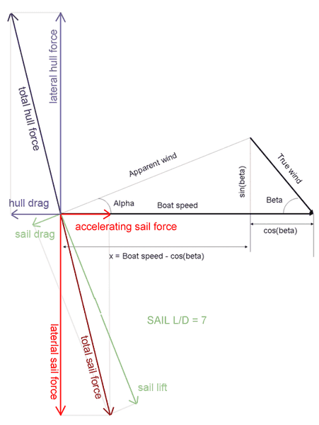

  • #39
kmarinas86 said:
For tacking to allow velocity made good to exceed windspeed, the angle between sails and the apparent wind cannot be held fixed with time.
An ice boat can maintain a steady speed with velocity made good down wind exceeding wind speed indefinitely (as long as there's room) with the sail at a fixed angle. There is a vector chart in this article:
ice_boat_performance.pdf
that shows a true wind speed of 18 mph, ice boat speed of 70 mph, and apparent wind of 55 mph. Cleaning up the numbers a bit, change apparent wind to 55.15 mph. This corresponds to a true wind heading of 0° at 18 mph, and an ice boat heading of 30° at 70 mph, with an apparent wind heading of -140.61° at 55.15 mph (= 39.39° at -55.15 mph). The apparent wind can be separated into components perpendicular and in the direction of the ice boat. The apparent crosswind is 18 mph x sin(30) = 9 mph, regardless of the ice boats speed. The apparent headwind is ice boat speed - 18 x cos(30) = sqrt(apparent_wind2 - apparent_crosswind2) = 54.41 mph.
The key factor here is that apparent crosswind is independent of the ice boat's speed, so the maximum speed is related to the maximum ratio of apparent headwind versus apparent crosswind that the ice boat can achieve for a given true wind and ice boat heading relative to true wind.
The other requirement is that the ice boat's sail must divert the apparent wind upwind by some amount, so that the diverted apparent wind slows some of the true wind air (wrt ground), since slowing the air is the source of power for an ice boat.
I assume that land boats can also achieve vmg downwind greater than wind speed. I don't know if a catamaran in water could accomplish this.

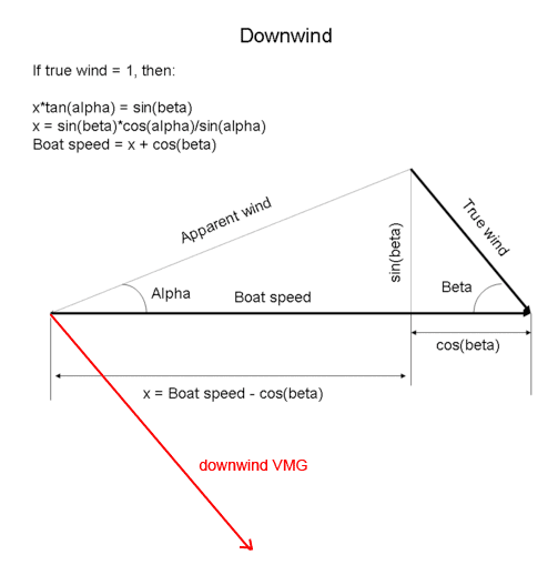

rcgldr said:
An ice boat can maintain a steady speed with velocity made good exceeding wind speed indefinitely (as long as there's room) with the sail at a fixed angle. There is a vector chart in this article:
I assume that land boats can also achieve vmg greater than wind speed. I don't know if a catamaran in water could accomplish this.
The document you cite (http://www.nalsa.org/Articles/Cetus/Iceboat Sailing Performance-Cetus.pdf) has a chart on page 2 of 6 that proves that the ice boats in question were not in a steady state (i.e. not having both constant speed and direction simultaneously).
In a few past posts of mine here, I made the mistake of using the term "velocity made good" where I have actually meant "velocity made good, assuming that the next mark is directly downwind as is (effectively) the case of the tests of the Blackbird DD(T)WFTTW land yacht."
Directly (or dead) downwind means alpha=180 degrees (See http://en.wikipedia.org/wiki/Sailing_faster_than_the_wind#Speed_made_good and http://en.wikipedia.org/wiki/Sailing_faster_than_the_wind#Sailing_dead_downwind_faster_than_the_wind).

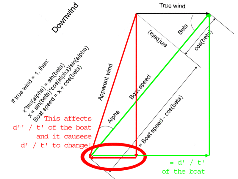

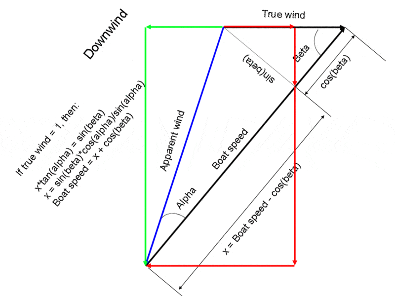

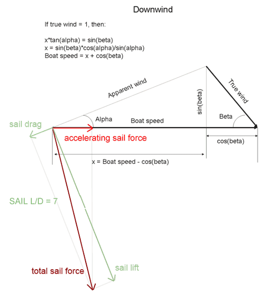

  • #54
kmarinas86 said:
A sail boat whose velocity made good exceeds wind speed uses water as a reaction mass to attain this excess speed (for all one must do with that is to turn the vehicle, after it exceeds wind speed, toward direct downwind),
No. A sailcraft can achieve and hold a steady state downwind VMG > true wind at a constant course in constant true wind. You don't have to turn the vehicle at all.
http://img253.imageshack.us/img253/6694/downwindvectorsen3.png
kmarinas86 said:
On top of this, many of your videos (the ones showing the gears) apparently depict the tailwind as providing a steady thrust when actually that tailwind is replaced by an unmistakable headwind.
Propellers can produce thrust in apparent head wind.
kmarinas86 said:
The sailboats simply cannot exceed windspeed downwind without changing the angle of the apparent wind...
For a sailboat the angle of the apparent wind changes, even when you accelerate at a constant course in constant true wind. The angle of attack at the propeller blades changes in the same way during acceleration.

The true wind is perpendicular to the blue stripes on the surface. The balloon goes directly downwind at windspeed. The boat goes at an angle to the true wind, with a downwind VMG > true wind. So the boat outruns the balloon along the true wind direction. This is a physically perfectly valid steady state situation (see vectors in previous post).
Jibbing is irrelevant to achieve this. In fact, changing tacks only slows down the boat as it goes through DDW. The continuous helical tack of the propeller blades eliminates that problem.

It appears that you do not believe that traditionally rigged sailing vessels (be they on land, water or ice) do not and cannot achieve VMGs of greater than wind speed while on a steady course heading. This is simply not true. Until you correct this aspect of your physics understanding, you will be fighting a steep uphill battle in understanding the DDWFTTW vehicles.
Perhaps this link would help with your understanding of the topic. It contains all the maths, vector diagrams and real world examples (along with plenty of enlightening exchanges on the discussion pages) that show your position on this to be flawed.
Traditionally rigged sailing vessels easily and regularly exceed 1.0 vmg on steady course -- often by a very large margin.

Not so if vmg is parallel to steady wind of unchanging course! I've been to that page several times, and it still doesn't refute my point. Take for example the picture for boat speed downwind:
http://upload.wikimedia.org/wikipedia/en/4/4f/Wiki_sailing_vector_downwind.png
Note that alpha+beta=180-(90-alpha)-(90-beta). So the component of the apparent wind applied to the boat in the direction opposite of the true wind is equal to apparent wind speed*cos(alpha+beta).
Given that alpha and beta are positive angles, when the boat is going downwind faster than true wind (0 degrees < 180-(90-alpha)+(90-beta) < 90 degrees), cos(alpha+beta) > 0. Therefore, as soon as the boat overtakes the true wind, the apparent wind applies a force component on the boat against the direction with respect to the true wind. As alpha+beta approach 0 (parallel condition), the apparent wind speed on the boat against the direction of the true wind approaches boat speed minus true wind speed.
kmarinas86 said:
In both scenarios, the sail (seen here as not jibbing) should only be able to beat the balloons drifting with the wind if the wind is not parallel to the left-to-right axis. However, in DDTWFTTW, velocity made good must be parallel to downwind (and anti-parallel to upwind). The video therefore relies upon two contradicting assumptions about the direction of the wind even though it speaks of only one of them.
The above was the further elaboration of my point about this not having to do with tacking.
