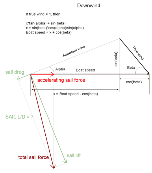

Therefore, as soon as the boat overtakes the true wind, the apparent wind applies a force component on the boat against the direction with respect to the true wind.
Split up the apparent wind into components perpendicular and parallel to the boat's heading. An apparent headwind applies an aerodynamic drag to the boat, while an apparent crosswind is diverted to produce thrust by the sail. Note that apparent crosswind is independent of the boats speed: apparent crosswind = true wind speed x sin(boat heading - true wind heading). As long as the thrust to drag ratio is high enough, a boat can achieve vmg downwind greater than true wind speed while tacking at some angle (around 30° to 40°, depending on circumstances).
  • #64

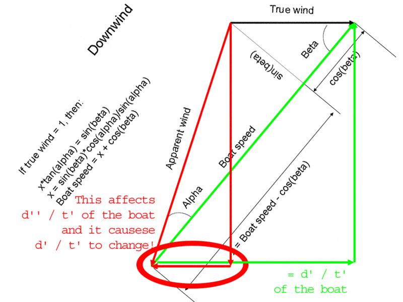

The components you mentioned were already in the original picture and had nothing to do with the force directed parallel to the direction of the wind.
Instead of projecting the apparent wind onto axes parallel and perpendicular to the boat speed, I split up the apparent wind into components perpendicular and parallel to the wind's heading in lime green.
Your components:
* x = Boat speed - cos(beta)
* sin(beta)
My components:
* apparent wind speed*cos(alpha+beta)
* apparent wind speed*sin(alpha+beta)
In the second image below, I split up your two components into four, shown in red.
  • #68
A.T. said:
Nope, this makes no sense at all. Acceleration is determined by forces, not velocities. Where are the forces in your diagram?
None, as this was not a force diagram. It is a velocity diagram. The red text I added was not identify the red vectors as forces. The vectors are obviously velocities as none of them are forces. The text "This affects d'' / t' of the boat[,] and it causes d' t' to change." is a description of the consequences of the red vectors in question, not of the red vectors themselves. Two of three red vectors are components of the apparent wind velocity. The third and longest one represents the apparent wind velocity itself. The consequences (not depicted graphically here) are the forces which vary by the square of the vector magnitudes here depicted and the power which varies by the cube of the vector magnitudes here depicted, so taking that into consideration, it is clear that decomposing them in the same way as the velocity vectors would result in a diagram where the angles have no physical relevance to path of the boat other than its derivative with respect to time, and indeed I have not done so with the above modified diagram, as it is only a velocity diagram applicable for an instant of time. The force on the sail is not even balanced here without incorporating friction. Once you do that, then you would have explain how friction would act against the apparent wind, when it is obvious that the apparent wind is able to push as a result of the fact that it is itself a source of friction providing a force on the craft.

The deflection of the apparent wind off the sail means that the apparent wind does not maintain the same direction when approaching versus leaving the sail. Any deflection at an exact right angle to the sail's momentum direction does not add energy to the boat. It simply redirects the direction of the boat. Any force component at a right angle to a momentum direction only deflects it, leaving its norm unaffected. Does this deflection add to the kinetic energy of the boat? No. It can only deflect whatever kinetic energy is already there. Only forces parallel or anti-parallel to the motion in question will allow for the kinetic energy of the boat to change.
  • #71
Yes, and the "accelerating sail force" is parallel to the boat velocity. It will accelerate the boat until the hull drag matches it. Here all the vectors for constant velocity (net force = zero):
