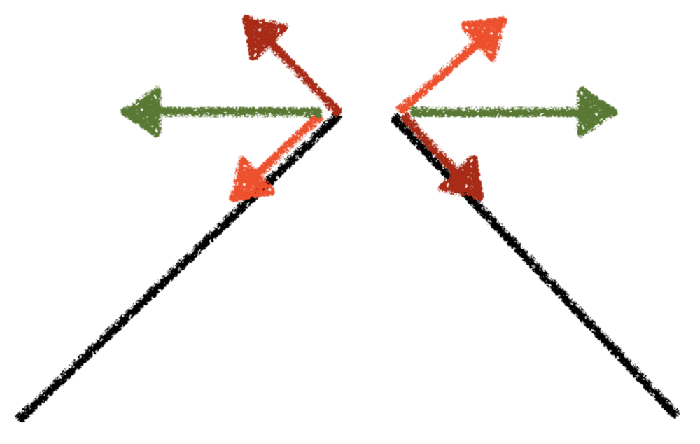

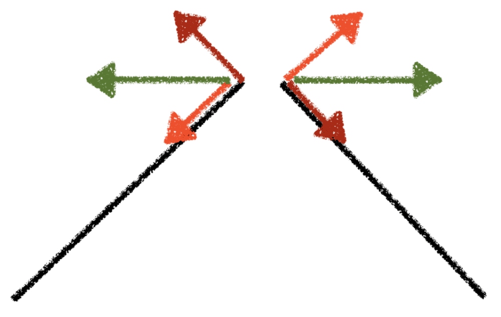

Here are the two rods, hinge not shown. The two pairs of contact forces are as shown in red/orange, and their resultants in green. Note that the red and orange components are not necessarily of equal magnitude! Any combination of magnitudes is initially possible. Though in the case that both components happen to have the same magnitudes, the resultants are indeed horizontal if the rods are initially at 45 degrees.
I really admire your artistic work :)
I was talking about the rods PR and SP. Please draw the diagrams for them, it’s a request.
