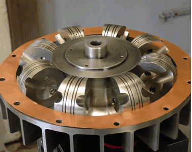

opinions?View attachment e.pdf
chhitiz said:perhaps that's all you are capable of.
chhitiz said:can somebody tell me how to calculate efficiency?
chhitiz said:yes I've checked there are no toroidal engines which resemble my design. could anybody tell me what to do next?
chhitiz said:in this design, the piston stops all by itself ...
chhitiz said:but, it would help, if you could assume that what i have designed is possible to build and seal, and then guide me as to how to calculate, at least in theory the efficiency, or simulate this design on some software. as far as i know, ansis or pro-e won't do.
what are the engines with similar compression ratios? any of them toroidal?Mech_Engineer said:Just making a guess based on engines with similar compression ratios is your best bet IMO, and that will likely be around 15-20%.
chhitiz said:... guide me as to how to calculate, at least in theory the efficiency ...
chhitiz said:... can we simply guess the efficiency based on c.r.? is there a way to calculate the precise efficiency of a completely new design?
chhitiz said:... could people anyways suggest a way to calculate efficiency or something ...
it was made in catia. and as far as i know, there is no way of getting the stresses in it.Unit91Actual said:It looks like you made that in Abaqus (?). If so, did you run an FE simulation to see what types of stresses are in the engine? One of the biggest concerns in efficiency is thrust to weight ratio (T/W). If you want to take this to the next step, I recommend seeing what your stresses are like, and determining if you have too much / too little material. Factors of safety are also important.
efficiency is how much of the chemical energy of the fuel is actually converted into useful work. and calculating it is different because this design will have a totally different thermodynamic cyclegmax137 said:What exactly do you mean by 'efficiency'? Can you write down what you mean in words, and then take a stab and quantifying it? Why do you think calculating it is any different then the 'efficiency' calculations described in the automotive engineering textbooks?
