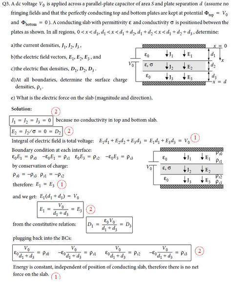

I'm confused as to how he makes the conclusion for the last portion of the question.
I would have had the following thought process,
\vec{E_{2}} = 0 = q\vec{F_{2}}
q \neq 0
\Rightarrow \vec{F_{2}} = 0
Is this incorrect?
If so, where's the math behind his answer? I'm just not seeing it.
Well, the fixed voltage and charges (on the upper & lower plates) imply that the potential energy stored in the capacitor is a constant.
Your professor is using the relation F = - \nabla \cdot U to show that the constant potential implies zero force.
