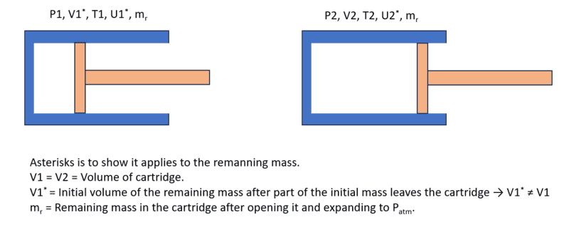

This is the result I get when solving the problem with the closed system approach as you suggested:
CLOSED SYSTEM - ISOTHERMAL PROCESS
##m_0=.00012kg; P_1=5860546Pa; P_2 = P_{atm}=101325Pa; T_1=T_2=298K##
The cartridge volume can be found using the equation state.
##PV=mRT \rightarrow V_1=\frac{mRT_1}{P_1}=1.152*10^{-6}m^3##
After the expansion, the remaining mass ##m_r## will occupy the same volume ##V_1=V_2##. It is then possible to find the remaining mass again with the equation of state.
##PV=mRT \rightarrow m_r=\frac{P_2V_2}{RT_2}=2.074*10^{-6}kg##
That remaining mass initially occupied a smaller portion of the cartridge ##V_1##. Using the equation of state again I get.
##PV=mRT \rightarrow V_1^*=\frac{m_rRT_1}{P_1}=1.993*10^{-8} m^3##
Finally, work done by the remaining mass can be expressed as you posted.
##W=P_1V_1^* \ln \frac{P_1}{P_2} = -P_2V_2 \ln \frac{P_2}{P_1} = 0.473J##
This is a very small number when compared with the energy obtained by all the mass in the cartridge isothermally expanding from 850PSI to atmospheric pressure but I think it's right. Do you think the method to solve it is correct?
CLOSED SYSTEM - ADIABATIC PROCESS
##m=.00012kg; P_1=5860546; P_2 = P_{atm}=101325Pa; T_1=298K; C_v=657 J/kgK; k=1.289##
Again, it's necessary to find the remaining mass in the cartridge. The cartridge volume is the same as before.
In this case, less information from State 2 is accessible from the beginning. It is then necessary to use equations from the adiabatic expansion.
##v_1 = \frac{V_1}{m}=0.0096 m^3/kg##
##P_1v_1^{k}=P_2v_2^{k} \rightarrow v_2 = e^{\frac{\ln \frac{P_1v_1^k}{P_2}}{k}} =0.224 m^3/kg##
Then, the remaining mass in the cartridge will be:
##m_r=\frac{V_1}{v_1}=5.153*10^{-6}kg##
Also, once ##v_2## is known, it's possible to find ##T_2##.
##PV=mRT \rightarrow Pv=RT \rightarrow T_2 = \frac{P_2v_2}{R} = 119.98K##
Finally, the output work will be the same as the change in internal energy since there is no heat involved (adiabatic process).
##W=-m_rC_v\Delta T = 0.602J##
Somehow, I obtained that the output work is greater if the expansion is adiabatic instead of isothermal. That feels wrong in my head. The origin of that here I guess is that the remaining mass in the cartridge is greater in the adiabatic expansion because the cartridge is way cooler so the CO2 is denser.I initially proposed using enthalpy to solve the problem with energy transport and control volumes but while trying to run the numbers I realized I'm not capable of setting the equations to get the same results. Shouldn't both methods be equivalent? I need to work a little longer on that approach to find the breakthrough.

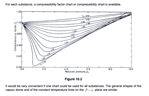

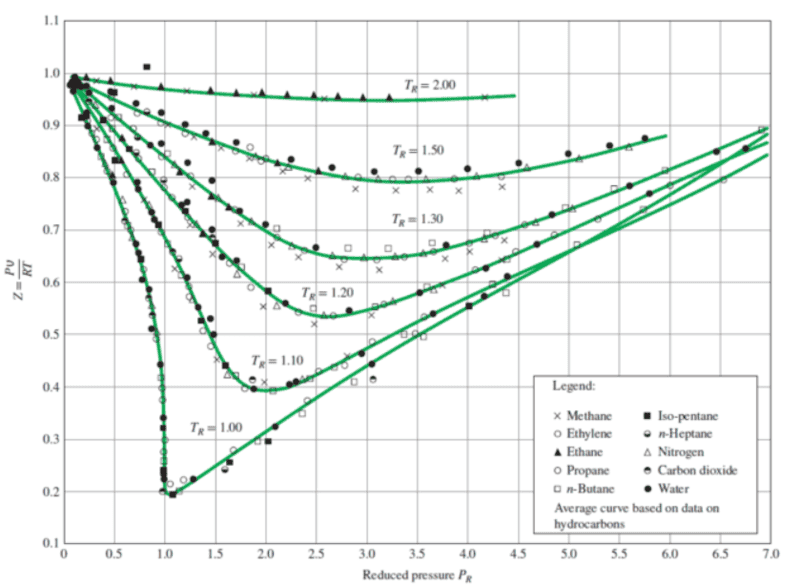

It follows from the Law of Corresponding states. This says that, for all substances, to a good approximation, z is same function of reduced temperature and reduced pressure, $$z = z (T_r,P_r)$$where $$T_r=\frac{T}{T_c}$$ and $$P=\frac{P}{P_c}$$where the subscript c signifies the critical point of the substance. A more accurate version involves the Pitzer "ascentric" factor ##\omega## which is likewise tabulated for each substance in thermodynamics books: $$z=z(T_r, P_r,\omega)=z^{(0)}(T_r,P_r)+\omega z^{(1)}(T_r,P_r)$$Graphs of ##z^{(0)}## and ##z^{(1)}## are found in most Thermodynamics books such as Smith and Van Ness, Introduction to Chemical Engineering Thermodynamics or online. Many books have graphs of the entire integral as a function of the reduced temperature and pressure.
Thanks. I'll try to work out the results in the coming days.
I'll check my books first to try finding ##z = z (T_r,P_r)##. If it's not there, I'll go to the sources you provided.
Chestermiller said:
I just found one although yours seems to be more complete (it goes further in the reduced pressure and higher in Z). Also, yours has more curves in it compared to what I found in my book.
The only advantage I can see in the one from my book is that there is a grid in the plot.
I think I got an overall idea of how to solve the problem. Choose a curve based on ##T_r## which we're considering constant because ##T## is constant through the expansion and ##T_{cr}## is a property of the gas that's also constant. Then, I'll divide the curve ##z## into two straight lines to integrate. It'd be just an approximation of what the integral would be but it'd provide some rough numbers.

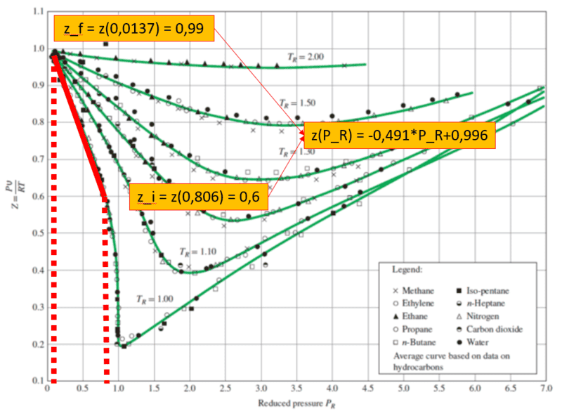

First I need to define the ##z## factor for this problem.
Temperature is constant so using ##T_R=\frac{T}{T_{cr}}=0.976 \approx 1## I can choose the lowest curve which is the closest to that value.
Second, I find in which interval of ##P_R## the expansion happens to linearize ##z## with either one or two straight lines. ##P_{R_i}=\frac{P_i}{P_{cr}}=0.806## and ##P_{R_f}=\frac{P_f}{P_{cr}}=0.0137##. It's then possible to conclude we're on the left side of that curve and only one straight line will be enough to approximate the problem. I'm eyeballing the values from the graph which is not ideal but I see this mostly as an exercise to learn. Feel free to try more accurate measurements if necessary and do the proper integral without the linearization if necessary.
Now that ##z## is known, we can tackle the expression for work.
$$W=mRT\ln{(P_i/P_f)}+W^R$$
$$W^R=mRT(z_f-z_i)+mRT\int_{P_i}^{P_f}{(z-1)\frac{dP}{P}}$$
For clarity, I'll solve it in chunks. First, this part is the same as the ideal isothermal expansion
$$mRT\ln{(P_i/P_f)}=2738.9J$$
Then, the first component of ##W_R##.
$$mRT(z_f-z_i)=262.14J$$
Finally, the last component of ##W_R## which contains the integral. First, I'll express ##z## in terms of ##P## to solve the integral.
$$z=-0.491P_R+0.996= -0.491\frac{P}{P_{cr}}+0.996$$
$$mRT\int_{P_i}^{P_f}{(z-1)\frac{dP}{P}}=mRT\int_{P_i}^{P_f}{(-0.491\frac{P}{P_{cr}}+0.996-1)\frac{dP}{P}}=272.5J$$
That's easily solvable analytically but I cheated to be a little faster and solved it numerically online to avoid writing the steps.
Anyway, assuming the previous calculations are OK, now we have all the components of ##W##.
$$W=2738.9+262.14+272.5=3273.54J$$
So it seems it's possible to extract about 20% more energy from the "real expansion" than from the "ideal expansion". Whether that's right or not I can't judge due to my lack of experience in these problems. Maybe I committed an error while inputting the numbers or in the derivation but I couldn't find it while checking the numbers myself.
