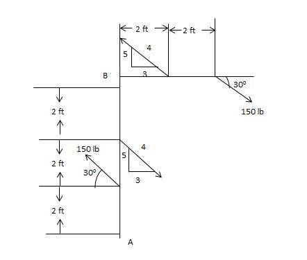

Determine the required magnitude of force F in the resultant couple
moment on the frame is 200 lb.ft clockwise.
##\Sigma F_x = \textbf{-}2*\frac{4F}{5}##
I have to find resultant for this couples:
243987

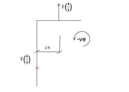

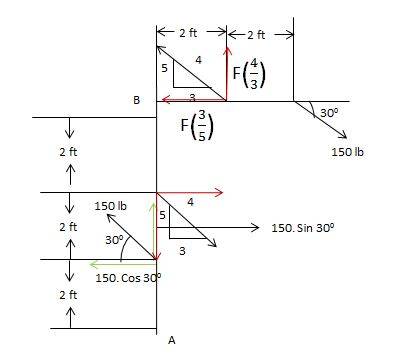

My sir resolved given forces into components like this:
243988
He considered Fx couples for sides 3,4,5 triangles:
243989
He wrote resultant force for this above diagram: ##\Sigma F_x = \textbf{-}2*\frac{4F}{5}##
You appear to have written the vertical component as 4/3 F, twice, instead of 4/5, and the horizontal once as 4/3 instead of 3/5.
Which point are you taking moments about?
