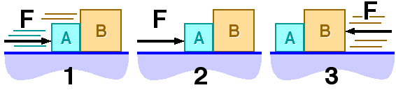

Consider two blocks, A and B on three surfaces. On each surface, block A is smaller than block B, and always positioned to the left (they are touching, with block B on the right). We have three situations:
1. Block A is pushed to the right on a smooth surface.
2. Block A is pushed to the right on a rough surface. The blocks are at rest, and force F is smaller than the maximum static friction force on A.
3. Block B is pushed to the left. The blocks move at constant speed.
The force F is assumed to be the same for each. When moving the blocks will encounter air resistance.
My problem here is deciding two things: In order from highest to lowest, I need to order them depending on the net force on block A. Also, I need to order them in the same way depending on the total friction exerted on A and B.
After drawing the free-body diagrams, it looks like there is the most net force on A in situation 1 (due to only wind resistance), second most in situation 3 (due to wind resistance and a small amount of kinetic friction), and the least in situation 2 (due to the high amount of static friction). Does this look alright (as far as my reasoning goes) or am I not including something?
For the second problem, I am saying 2>3>1 because 2 doesn't move at all due to the high static friction, 3 has both wind resistance and kinetic friction, and 1 has only wind resistance. Again, is this a reasonable answer?
I would appreciate your help in this (although please don't give away the answer to me) :smile:

For part 1), if an object is static, or moves with constant velocity, i.e. no acceleration, then the net force on the body is zero.
For part 2), that ordering and reasoning are correct/good.

I don't understand why it told you your answer was wrong.
In Fig 1, there may be some wind resistance, but the blocks are moving on a smooth (AKA frictionless) surface, therefore there is no friction and <1> is last in the order - as you had it.
In Fig 2, there is no wind resistance and no movement, so the static friction is simply equal to the applied force, so Fr,2 = F. (Fr,2 is the total friction on blocks in Fig 2)
In Fig 3, the block is moving at a constant speed, there is no acceleration, so the net force on the blocks is zero, so the forces must balance. The only forces are wind resistance, R, the applied force, F, and kinectic friction, Fr,3. (Fr,3 is the total friction on blocks in Fig 3)
The balance of forces is,
F = R + Fr,3
substituting for F = Fr,2
Fr,2 = R + Fr,3
=> Fr,2 > Fr,3
So, the ordering of (total) frictional force on the blocks is
<2>, <3>, <1>

OK, that may be my mistake - I think.
Air resistance is a form of friction, but I usually think of it as being referred to as drag.
I took the wind resistance here as being a resisting force rather than a frictional force.
If we consider the wind as contributing to the total friction, then what do we have ?
Part 2)
Case 1: The blocks are on a frictionless surface and have a force F applied to them. Let R1 be the wind resistance.The net force on the blocks is F - R1, so there is an accelerating force of (F-R1) which will increase the velocity of the block combination. Now drag, or wind resistance, is proportional to the velocity (or, the square of the velocity) and so R1 will increase in value as the blocks increase in speed until terminal velocity is reached, which is when R1 is equal to F and then there is no longer any net force acting and the blocks will continue at constant speed.
If the wind resistance is taken as friction, then the total friction on the blocks, in case 1, is
Friction1 = R1 = F
Case 2: The blocks are static, there is no wind resistance, only surface (static) friction, so the total friction on the blocks is the applied force,
Friction2 = F
Case 3: The block combination is moving with constant speed, so no net force. The wind resistance and surface (kinetic) friction balance with the applied force, F. Let R3 be the wind resistance and Fk be the surface (kinetic) friction. Then R3 + Fk = F
i.e. total friction on the blocks is,
Friction3 = F
Now, according to this analysis, all cases have the same amount of total friction, therefore they cannot be ordered - which is a bit crazy !
I still can't see how the different block sizes make any difference. Drag will alter according to the profile being presented to the wind flow. But as far as I can see the profile of the block combination is the same in either direction.
Can you tell me where this question came form ?
It was a problem from my physics class, which I still cannot get. The TA told me that I have the correct reasoning (2>3>1), but there was a misprint in the problem and it was supposed to say that figure 3 is smooth also, thus 2>1=3. However, when I entered this into the system (it was an online homework), it told me once again that I was incorrect.
