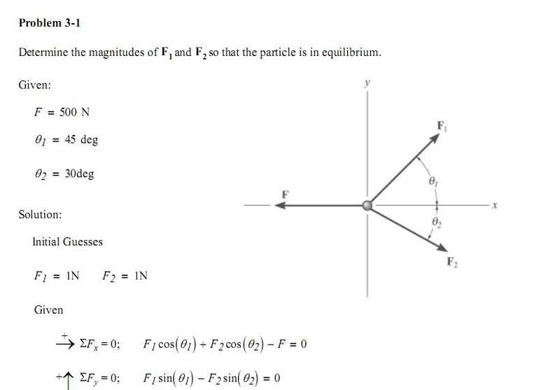

I am given this
I got the equation
Fx= 0 = F1 cos (45) + F2 Cos(30) - 500N
F1 .70 + F2 .86 - 500 N
Fy= 0 = F1 Sin (45) - F2 Sin(30)
F1(.70) - F2(.5)
how can I find F1 & F2 to Solve
Please
Thank you
I don't know
am I suppose to use Fy equation to find F2 in FX ?
Simply use the 2 equations that you have and solve.
You know already from the second equation that F1 = F2*(sin30/sin45)
Substitute in the first equation and solve ...
