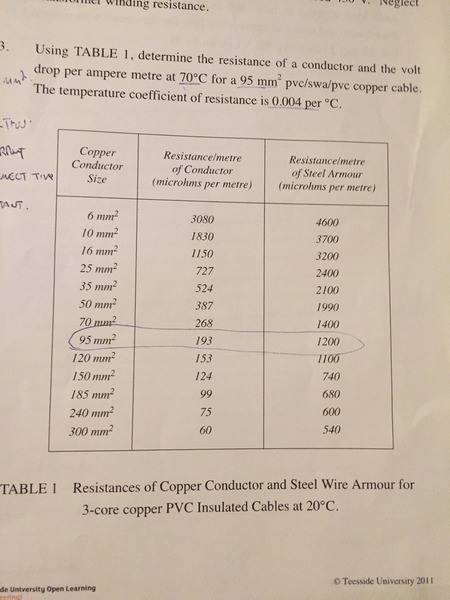

Determine the resistance of a conductor and the volt
drop per ampere metre at 70°C for a 95 mm2 pvc/swa/pvc copper cable.
The temperature coefficient of resistance is 0.004 per °C.
[/B]
R70 ( resistance at 70 degrees ) = R20 [ 1+( temperature coefficient of resistance of copper X's temperature difference ) ]
[/B]
Hi there folks!
I have the above question as part of work I'm doing on a course that I'm studying.
I've found what the resistance/meter is by using the following equation:
R70 ( resistance at 70 degrees ) = R20 [ 1+( temperature coefficient of resistance of copper X temperature difference ) ]
I was provided with a table which showed the resistance/meter for cables at 20 degrees.
My notes have in all examples given the volt drop per ampere per meter so I'm not 100% sure on how to obtain it myself. I'm thinking that this resistance is the same value as volt drop per ampere per meter as using ohms law V = I x's R and therefore 1 amp multiplied by R70 from above equation should give a volt drop per ampere per meter.
Is my thinking correct?
Any thoughts would be much appreciated!
Neil

Hi there, i have the same question and also found this a little confusing as Neil Hayes.
So i have calculated my R70 as
R20x[(1+0.004x50)]
R20 = From table 1 193 + 1200 ( 193 is the resistance/meter of conductor 1200 is the resistance/meter of steel armour. Both given in Table 1)
so 1393 x 1.2 = 1671.6 microhms meter
therefore volt drop = 0.0016716A per meter
Any help would be greatly welcomed
Thanks Tom

Wouldn't the steel jacket be in parallel with the copper conductor?
Why would the same temperature coefficient apply to both metals?
Are you sure it isn't just the resistance of the copper conductor that's of interest?

I don't have the benefit of seeing your learning materials, so I can't comment on any example you're following. My thoughts are pretty much embodied in the questions I posed. When I think of a steel-armored copper cable I think of a central copper conductor surrounded by an insulating sheath, surrounded by a steel sleeve or braid, surrounded by more insulating material. I'd think that the steel wouldn't be in contact with the copper anywhere except possibly at the ends of the cable where a manual connection of some form would be required. Two different metals being in contact is usually a big no-no for corrosion and electrolytic activity (the junction acting like a crude battery and ensuing chemical reactions hastening corrosion).
My instincts would be to deal with the copper conductor alone.
If you can share the original text of the problem statement and perhaps a link to, or an image of, the relevant data table that might help.

Thanks. I strongly suspect that they want you to consider the resistance of the copper conductor only for the first question.

So in that case would you agree with me on
R70 as R20x[(1+0.004x50)] R20 = From table 1 193
so 193 x 1.2 = 231.6 microhms meter therefore volt drop = 0.0002316A per meter
As my answer for 3.
Thanks again
Looks okay except for the voltage drop units. I suppose I'd quote the voltage drop per ampere-meter as ##232~\frac{μV}{A m}##, rounding to three significant figures.
