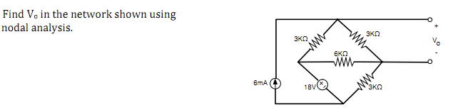

nodal analysis
When i did the problem, i got 3V. Is this right or wrong?
