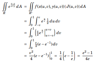

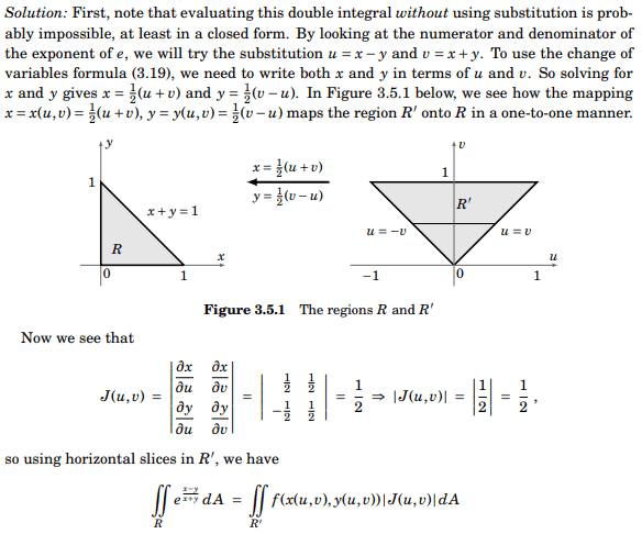

Summary: Evaluate ##\displaystyle\iint\limits_R e^{\frac{x-y}{x+y}} dA ## where ##R {(x,y): x \geq 0, y \geq 0, x+y \leq 1}##
Author has given the answer to this question as ## \frac{e^2 -1}{4e} =0.587600596824 ## But hp 50g pc emulator gave the answer after more than 11 minutes of time 1.11888345561.

Author's answer
Handwritten-style solution figure: triangular region R with vertices at 0, 1 on the x-axis and y-axis bounded by x + y = 1, next to a transformed region R' bounded by u = -v and u = v with v up to 1, and the Jacobian computed as 1/2.
Handwritten-style worked derivation of a double integral of e^((x-y)/(x+y)) over region R, changed to variables u and v, evaluated step by step to (e^2 - 1)/(4e).
Now, How to decide which answer is correct?
