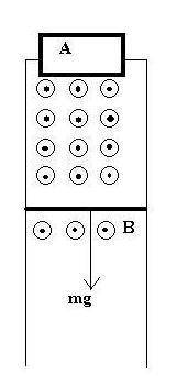

can anyone help me with this question from my homework?
i have the system in the picture and i need to find out the type of movement of the bar.
the box named A is an inductor, the 2 long parallel lines are infinite conductors. there's a magnetic field into the page. the black bolded line is a conductor with a mass of M and weight of Mg.
there's no resistence in the circuit.
and all i need to find is the type of the movement
thank you very much!
i forgot to attach...
the circuit

as far as i know about inductors i think it'll make an harmonic type of move...

What is the net force on the system?
Do you think there will be current flowing in the wires?
If yes, which direction do you think the current will flow in?
>>"What is the net force on the system?"
i know that the force is the sum of gravity and lentz law
i don't know if the'lly be equal or not
>>"Do you think there will be current flowing in the wires?"
i think there'll be current in the wires, there's also no resistence in the system, but the inductor has its induction which i didn't learn well enough
>>"If yes, which direction do you think the current will flow in?"
i know that the flow direction will be in the way that the lorentz force it'll cuase will be upside (resist to the change of the magnetic fkux)

They will not in general be equal. But, at least nature was nice enough to allow you to approximate gravity as a constant. If the rod starts from rest, then what is the Lentz force at this point in time? Better yet, what is the variable in this problem on which the Lentz force will depend (and I'll give you a hint, it isn't the area enclosed exactly, but it is related to that)?
Originally posted by ismael18
... the inductor has its induction which i didn't learn well enough
Do you know the value of the inductor? A voltage will develop across it to counteract a change in current (which is very much like the same principle as the Lentz force. In fact, the big rectangle is a big inductor). The formula is V = L(di/dt). You can relate this to a change in a magnetic field (and therefore flux).

That's correct, and I'm pretty sure that is all you need to know about the direction. Both the inductor and the Lentz force will oppose change in the magnetic flux.

It may be instructive to solve this problem ignoring the inductor first. (That's probably what I would do since I know almost nothing about AC circuits.)

I got a result of the form:
x(t) = x0 + A t sin(ω t + φ(v0))
I neglected the energy term in the magnetic field produced by the current in the loop, and only used the magnetic reactive energy in the inductor and the kinetic energy of the rod. I assumed an ideal inductor and frictionless rails, so the sum of these two energies should be a constant. Then I used the diff. eq. for the inductor and Faraday's Law to get a 2nd order ODE in velocity. Anyone please verify this for ismael and me. I am utterly uncertain of it.
If the form above is correct, then it looks like you were correct about the harmonic motion, ismael. Good intuition.
You should definitely not be getting any kind of occilations.
Let me give it a whirl:
The energy stored in the inductor is:
[tex]E=\frac{1}{2}LI^2[/tex]

so I have:
[tex]mgh=\frac{1}{2}LI^2+\frac{1}{2}mv^2[/tex]
Now all I need is an equation relating the velocity to the current which comes from Faraday's laws...

Oh crap! I forgot to include the grav. pot. E. I think that makes it orders of magnitude more complicated than even the way I did it, for which I had to look up an integral (though it was an inverse trig one, so it wasn't that bizarre, and I really should have it memorized).
Now, the rate of change of the flux is going to be proportional to the velocity, so let's (for now) say that
[tex]I=kv[/tex] for some [tex]k[/tex].
so we have:
[tex]mgh=\frac{1}{2}Lk^2v^2+\frac{1}{2}mv^2=[/tex]

[tex]\sqrt{\frac{2mgh}{Lk^2m}}=v[/tex]
Of course this is somewhat less than ideal if you want to have velocity as a function of time, instead of velocity as a function of position.
If you're looking for intuition, I would guess that you will end up with constant acceleration.

Whince did you get this? I thought that the changing flux would induce an emf directly, and only indirectly induce a current. The way I understand it is that the emf around the circuit is
Vccw = -Blv.
Then, this is the emf across the inductor (because the inductor is the only non-trivial electronic element), which gives an expression for the current as
-Blv = L(diccw/dt)
or
Bl(dy/dt) = L(diccw/dt).
That's one diff. eq. with two dependent variables, y(t) and i(t). Then, to get another equation, you use the energy relationship (the one that you corrected for me by including gravity). But this system is non-linear (and therefore scary to me).
