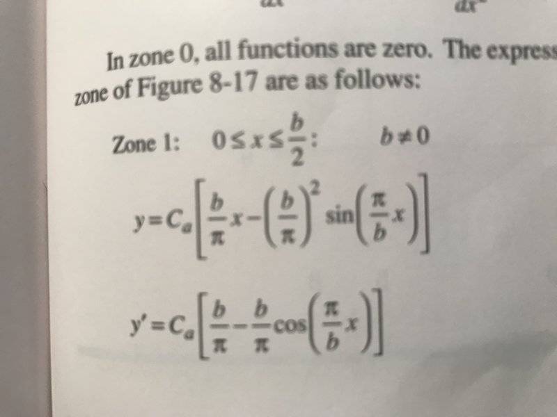

in the textbook, it says:
Printed textbook page showing zone 1 expressions for 0 ≤ x ≤ b/2 with b ≠ 0: y = C_a[(b/π)x − (b/π)² sin((π/b)x)] and its derivative y' = C_a[b/π − (b/π)cos((π/b)x)].
how does the integral of y'' gives you y' like that?

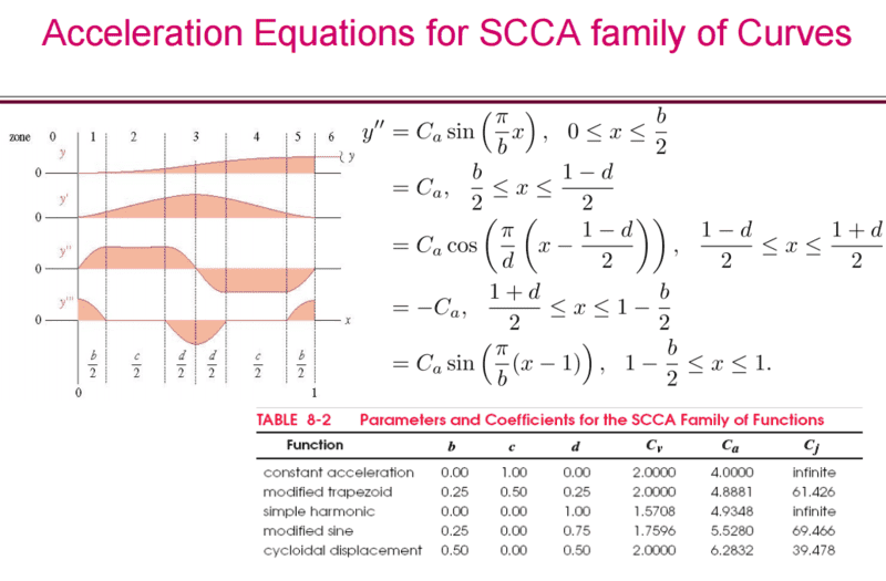

Slide titled Acceleration Equations for SCCA family of Curves showing plots of y, y', y'' and y''' against x in zones 0 to 6, with piecewise equations for y'' and a table of SCCA parameters b, c, d, Cv, Ca and Cj for five function types.
given C_a is a dimensionless peak acceleration factor.

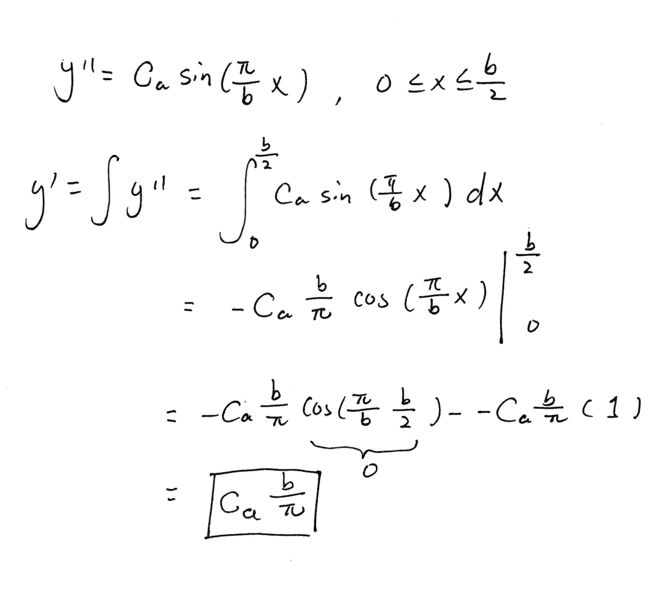

Handwritten calculus derivation: y'' = Ca sin(pi/b x) for 0 ≤ x ≤ b/2, integrated to y' = -Ca (b/pi) cos(pi/b x) evaluated from 0 to b/2, giving Ca b/pi.

You seem to be confusing definite and indefinite integrals. The indefinite integral is an antiderivative of the function, but a definite integral is a number.

but if I do it as indefinite integral, the result would be more confusing to me: y'= -C*(b/π)*cos(πx/b), which is totally different from what the book has.

Your integral is the definite integral up to x=b/2 and it looks like their integral is the integral up to a variable x (0≤x≤b/2)

So, what do you get if you integrate ##y''##? Remember you need a boundary condition of some sort to quantify the constant of integration.

I got this:
Handwritten derivation: y'' = Ca sin(pi x / b) for 0 ≤ x ≤ b/2, integrated from 0 to b/2 to get y' = -Ca (b/pi) cos(pi x / b) evaluated, giving Ca b/pi, boxed.
but it seems like I should be integrating up to x instead of b/2, I don't know why though, I must have forgot something important in integrals...

If you integrate a function on a definite interval, you simply get a number. Take a simple example like:
##\int_0^{\pi/2} \cos(x) dx = 1##
But:
##\int_0^{x} \cos(u) du = \sin(x)##
Note the need for a new dummy variable for the integrand.
Altertnatively:
##\int \cos(x) dx = \sin(x) + C##
Where ##C## is specified by some boundary condition.

Yeah, you forgot that a definite integral is a number.

wow, thank you, I forgot b/2 is a definite interval on the graph.
Right. And if they will do more integrals of this result, they need the formula for the general integral, not just the value of the definite integral. So this is not a definite integral.
