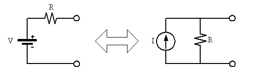

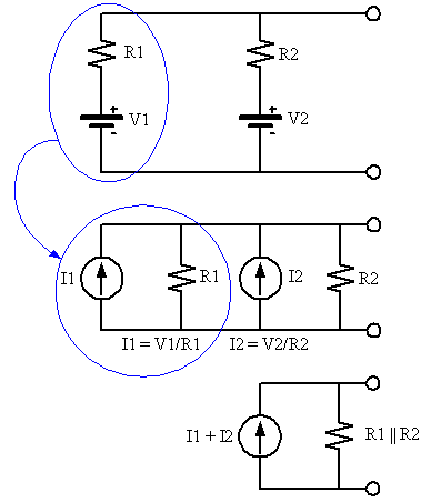

Three of the various ways to solve it (and all three can come in handy at times):
1. KCL at node (a) and KVL for the three branches; four equations in four unknowns (but you need only solve for Va).
2. KVL for the two loops; two equations in two unknowns (the loop currents). Solve for one of the loop currents and apply it to the appropriate branch that it flows through alone to calculate Va (the current causes a voltage drop across the branch resistor. Add that to the voltage supply in that branch).
3. Convert all the voltage supplies and their series resistances to their Norton current supply equivalents. They'll all be in parallel and will simply add (like FP desired to do with the voltage sources!). The Norton resistance is just the three resistors in parallel. You're left with a single current supply and one resistor. Voltage? Easy: Va = I*R.
This one is the easiest and nicest solution, thank you, gneill!
Well, yes, thank you, but I never heard of this " Norton current supply equivalents"! It seems to be the key I was looking for but never had any practice in it. Do I just add voltage soruces in parallel the same way I do with resistors?

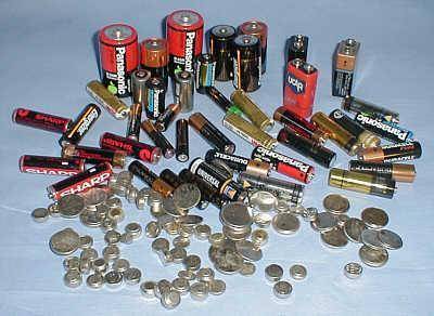

Have you ever cut a real battery to two halves? Such ones as in the picture?:biggrin:
ehild
