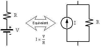

But, by all means learn this method because it is very useful to know it.
Once you have the parallel combination of resistors and current sources, then add the currents and parallel combine the resistors. You will be left with one current source and one resistor. Then just multiply resistance times current to get the voltage.

The Norton equivalent is really simple in this special case. Imagine you have a black box, with two terminals and you can connect different loads across them and measure the terminal voltage and the current through the load. Till the device in the box is linear, the graph I(V) is a straight line. You can get the same I(V) characteristics from a single ideal current source and an internal resistance connected across it. The current source provides current equal to the short-circuit current Is measured with zero-resistance load. The internal resistance Rs is equal to the open-circuit voltage (Vo) divided by the short-circuit current (Is), or simply the resultant resistance inside the block between the terminals. It is analogous to the Thevenin equivalent but that replaces the black box with a voltage source of emf=Uo and a series internal resistance Rs=Uo/Is.
To FP, I suggest the two-loop KVL method. She knows it.

Perhaps an elementary introduction to Norton current equivalents is in order. The basic premise is that a voltage source with a series resistance is in every way equivalent to a current source with a parallel resistance. They are interchangeable in a circuit being analyzed, and in a number of circumstances can make the analysis easier.
Have a look at the first attached figure. On the left hand side is a voltage source V with a series resistance R. On the right, it's equivalent in current-source form. The value of I that should be assigned to the current source is I = V/R. That is, it is equal to the current that would flow in the voltage source circuit if its output were short-circuited; it's the maximum current that you could ever draw from the voltage source V with that series resistance.
Note that the open circuit voltage at the open terminals of the voltage source circuit is V; when no current is being drawn from the circuit, the voltage at its output is equal to that of its source, V. Similarly, for the current source version, when no current is being drawn from its terminals all the current I from the source flows through the resistor R, developing output voltage V = I*R, which is the same as that of the voltage source circuit. If the terminals of the current source circuit are shorted together, then all of the current I flows through that short circuit. Recall that I was also the maximum current that the voltage source circuit could provide.
The second figure summarizes these properties.
How does this help us to analyze your circuit? Consider the third figure where there are two battery+resistance branches in parallel. Suppose we want to find the net voltage at the output terminals. If we convert the voltage+resistance branches to their Norton current equivalents, as in the second diagram in the figure, you can see that you then have current sources and resistances in parallel. These can be combined by adding up the parallel currents and calculating the net parallel resistance. The resulting simplified equivalent circuit gives you the output voltage very easily indeed.

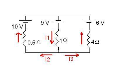

gneill, ehild, I'll get to your explanation of "Norton current equivalents" later, but you'd first recommended me to solve it more fundamentally using KVL, which I think I got figured out in terms of theory anyway -->
Shortcuts and fast methods are great, but shouldn't be used to circumvent the learning of the fundamentals.
Is this the fundamentals?
http://img36.imageshack.us/img36/1581/v111m.jpg
http://img193.imageshack.us/img193/5264/v222.jpg
And now for the grand daddy of all, solving it!
http://img580.imageshack.us/img580/8459/vlast.jpg
And I should get right about 20V = 0!
No, wait, what??
See that doesn't make any sense!
What am I doing wrong?

You have mixed signs again. Write the currents directly beside the resistors. Show the "walking direction" in both loops in the same figure. And I do not see I3 in the equations.
ehild

  • #48
Femme_physics said:
Are these the correct 3 eq 3 unknowns?
Looks right!
  • #49
Good morning Fp! :smile:
Femme_physics said:
I'm looking back at my equations and I see where my error is. I accidentally did -10V in my first equation whereas it should be +10V, right?
I believe so.
Edit: No, that is not all. You also have wrong signs for voltage drops across resistors.
That is the consequence of not drawing and applying the current directions correctly and consistently.
Almost. In your first equation you have mixed up a current, but that is all.
All the loops and signs are ok! :smile:
  • #50
I did fix the mixed current :)
Edit: That should be enough equations to solve, right?

  • #54
ehild said:
NO!
@ehild, I think you're confusing Fp here.
Her equations are right with the choices for the currents she made.
The resulting answer for the current is wrong though, but I'd have to see the calculation to find the mistake.

  • #58
Sorry, I misunderstood your drawing of the currents. It is all right, but I still suggest to draw the arrows in the circuit, beside the resistors and not somewhere else. See picture that I drew especially for you. :smile:
And I got different result for I2. Check the calculations. When you plug in I1=I2+I3 into eq3, the voltage is wrong.
ehild

  • #59
I think I can just solve 3 eq 3 unknown using a calculator. Let's see, it shows
I1 = -12.846 [A] (why is it a minus?!?)
I2 = -12.308 [A]
I3 = -0.53846 [A]
Was that your result, ehild?
  • #60
No, do not complicate things with that calculator.
You substituted I1=I2+I3 into the equation 9-I1-0.5I2+10=0, didn't you? Do it again, please.
