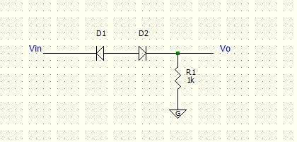

I have been given this problem as a homework assignment. I need to find the output voltage (V0) given an input of a 1kHz 10V peak to peak sine wave. According to the answer manual neither diode conducts. My reasoning behind this is that when the sine wave is +10V diode1 is reversed-bias and diode2 is forward biased and when the sine wave is -10V it's the opposite. Am I correct in saying so or is there another reason? Thank you.

Yes, that is right.
It also applies for all other voltage levels in the sinewave.
