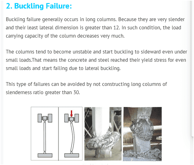

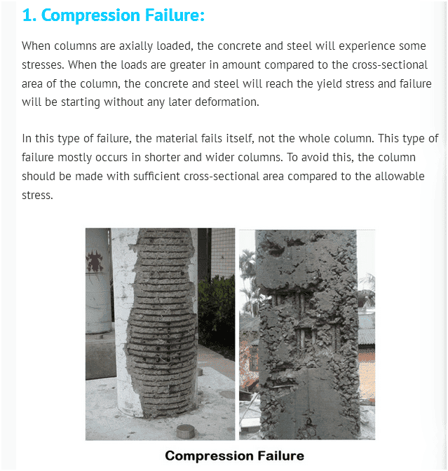

https://dailycivil.com/types-column-failure/
Two photos of concrete columns after compression failure: the left column bulges outward with horizontal cracking and spalling, the right column has its surface broken and crumbling, captioned Compression Failure.
Diagram of a slender column under load: left, a straight column between plates; right, the same column bowed sideways with a downward arrow. Two photos show buckled, deformed columns.

i was getting comfused because both had stress in them so thought it was the same
compressive strength = downward stregth resistance
Euler Stress = sideways to buckling
so by looking at the strength (220) and euler stress (350), it buckles higher than it does when compressing the column.
220 - 350 = 130MPa
is that normal for column?
in the reading material it uses compressive strength as the same value they use for critial stress for the column.
