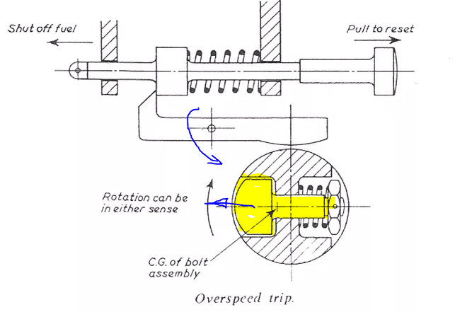

I want to estimate impact force generated due to collision between rotating body and stationary object. Bolt assembly is in balanced condition with the spring force and centrifugal force. As the speed of the shaft increases , centrifugal force on bolt assembly dominates the spring force which results in outward motion of bolt and thereby colliding with horizontal lever which thereby shuts off the fuel. Can you please guide me how to estimate impact force here.
243983
Bolt comes out by distance d=1.58 mm when speed of rotation of shaft reaches its trip value (w_trip). m is mass of trip weight (Bolt assembly)
One of the approach which I had considered is work energy theorem.
Initial energy = 0.5m*(w_trip*(r+d))^2
Final Energy= 0.5m*(w_trip*r)^2 (Assuming bolt will come back at a distance r (original position) just after impact, and speed will be remain same just after collision)
Workdone = friction force at knife edge (intermediate lever) * knife edge thickness at interface
I want to estimate mass (Bolt assembly(Highlighted))required to produce this work done or in other words, impact should be able to trip the system.

Impact forces are very difficult to calculate because they are dependent on the contact stiffness, mass of each part, and stiffness of each part. A general rule is that if the bolt head moves far enough to hit the trigger, it will eventually hammer the trigger far enough to trip the cutoff. Eventually could be one or two revolutions, or several dozen revolutions.
If the spring constant holding the bolt is low enough, the bolt will have two stable positions. It will be fully retracted up to the trip speed, then jump to the fully extended position at overspeed. With a stiffer spring, the bolt will gradually extend until it is lightly tapping the trigger, then eventually move the trigger far enough to trip the fuel cutoff.

Start with a free body diagram of the bolt. You have a force because it is spinning and the center of gravity is not at the center of rotation, and another force from the spring. One force is larger at low speed, the other force is larger at high speed. Calculate the forces vs speed for the bolt retracted and extended. Do that for a high stiffness spring with minimal preload, and a low stiffness spring with a larger preload. Both of those springs should have the same force with the bolt retracted.
Keep at it until you fully understand the relationship between bolt location (retracted vs extended) and bolt mass, bolt center of gravity location, speed, spring stiffness, and spring preload. Then, and only then, look at the rest of the mechanism. You need to fully understand the bolt and spring by itself before looking at impact. And you do not need simulation software to do this. You are better off using a pencil, paper, and a hand calculator.

In viewing the last example video, it appears that device does not depend upon any impact function. It simply extends the spinning actuator until it reaches an extension that moves the latch a sufficient distance to release the plunger. As a result, no impact analysis is required, the design is simply based upon balancing the centripetal force vs the spring force to get the required plunger extension at the desired rpm.

One difference between your design and the one above is the the one above has a slightly more than 180° contact cam that appears to possibly have a slightly elliptical profile (similar to the valve lift cams in an auto engine) that would minimize the lever acceleration of the point initial contact as opposed to your narrow striker that would have a more abrupt initial lift acceleration.

If this were two rigidly mounted striking items it would be easy; but because the lever deflects and that represents the same as striking a relatively soft material it is more difficult. In order to determine the minimum impact calculate the spring force at the point of contact with the lever in its rest (cocked) position and you will be able to determine the maximum travel of the lever at that force based upon the contact force/the spring rate.
Beyond that the calculation it gets more complicated because the rotating inertia of the lever at the above contact force vs its rotating inertia will then determine levers initial vertical acceleration at the point of impact and this then can be used to determine the travel of the lever vs to the resisting spring force. In the end this is what you really need to determine if your device will release the lever. (i.e In actuality, the lever will rotate/travel a bit further due to its inertia once in motion.) The only reason to worry about that actual contact force at the point of impact is if you are concerned about whether your your components materials are strong enough to prevent excessive wearing damage after repeated actuations.
