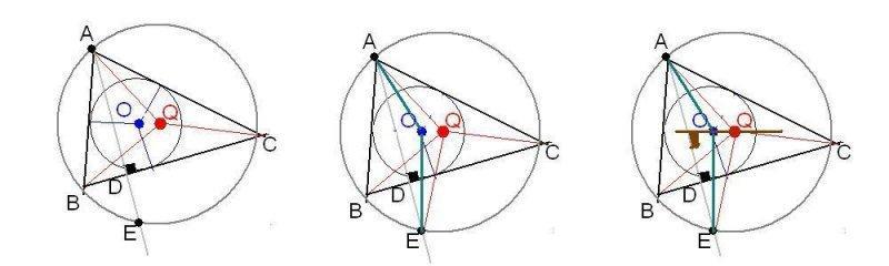

ABC is a triangle in which none of the angles is obtuse. The perpendicular AD from A to BC is produced to meet the circumcircle of the triangle at E. If D is equidistant from A and E prove that the triangle must be right-angled. If, alternatively, the incentre of the triangle is equidistant from A and E, prove that cos B + cos C = 1.
I can see that D must lie on the diameter as must B and C, so A must be 90 degrees. The second part of the question is where I am stumped. I have been trying to find an expression that constrains the incircle to be equidistant from A and E and transform that expression to the required one. I toyed with r = (a+b+c) where r is the radius of the incircle and a, b, c are sides of the triangle. However, I couldn't make any progress.

If you would include a diagram or sketch, that might help.
I attach a picture for the second question (the first is solved by the OP) .
O is the centre of the incircle with radius r, Q is the centre of the circumcircle of the triangle and the quadrilateral ABEC. As AO = OE and AQ = QE both O and Q are on the bisector of AE, and the line OQ is parallel to the side BC of the triangle, so both are at distance r from the side BC. Using that the incentre is the cross section of angle bisectors and the centre of circumcircle is the cross section of side bisectors, there are some useful right triangles. If a is the side BC, I got the equations a=r(ctg(B/2)+ctg(C/2)) and a=2 r tan(A), but haven't succeeded to go much further.
I succeeded at last. :)
Eliminating r from a=r(ctg(B/2)+ctg(C/2)) and a=2 r tan(A), and using that tan(A)=-tan(B+C),
##\frac{\cos(B/2}{\sin(B/2)}+\frac{\cos(C/2}{\sin(C/2)}=-2\frac{\sin(B+C)}{\cos(B+C)}##
Bringing the LHS to common denominator, using the addition formula sin(x+y)=sin(x)cos(y)+cos(x)sin(y), the equation can be simplified with sin((B+C)/2).
##\frac{1}{\sin(B/2)sin(C/2)}=-4 \frac{\cos((B+C)/2)}{\cos(B+C)}##
Using the identities sin(x)sin(y)=0.5(cos(x-y)-cos(x+y)), cos(x)cos(y)=0.5(cos(x+y)+cos(x-y)), and cos2(x/2)=0.5(1+cos(x)), we arrive at the desired formula.
