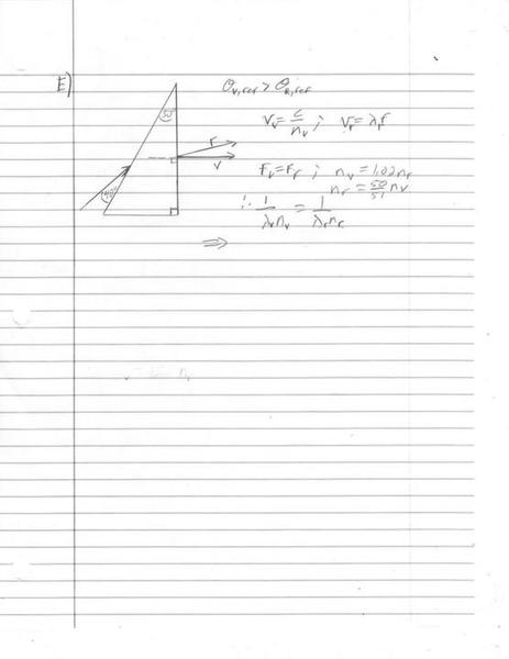

White light is incident onto a 30.0[deg] prism at the 40.0[deg] angle shown in the figure. Violet light emerges perpendicular to the rear face of the prism. The index of refraction of violet light in this glass is 2.00% larger than the index of refraction of red light. At what angle (phi) does red light emerge from the rear face?
on paper
So This is what I was thinking, but not sure if I can use those equations like I did.
Also, if the violet light is refracting perpendicular, that means it was not perpendicular to the right side before it exited/refracted, right?..
Thanks for your help!
You need the refraction formula with the angles in it.
n1*sin(θ1) = n2*sin(θ2)
In the special case where θ2 = 90 degrees, it doesn't matter what the indices are; you can immediately calculate θ1.
Having that θ1 for incidence on the right side, you can work your way around the triangle to get the angle of refraction into the left side, then use the formula again to find the index of refraction for violet light in the glass.

Hey Delphi51 thanks for responding! I really want to get this problem.
So how is θ2=90[deg] (if θ2 is the angle between the violet ray and the normal to the right surface)? I assumed it was 0[deg] to the normal.
And if θ2 was 90deg, sin(θ1)=n2/n1 right? How do the indices not matter?
Oops, sorry. Of course θ2=0. So θ1=0.
What is the angle of incidence for the left-hand surface?
What is the angle of refraction for the left-hand surface (for violet light)?

Oh. Ok.. So since the violet light is parallel with the base of the triangle, I'm finding nviolet with n0sinθ0=n1sinθ1 on the left side considering θ1 to be 30deg from normal of left surface and θ0 to be 50deg.
The question states nviolet = 1.02nred right? I'm going to work with that..
Did you get the number for the violet index of refraction (from knowing the angles of incidence and refraction for the first surface)? Then you can get the red index and do the refraction at the second surface. You don't need to work with wavelengths at all.

I get 50 deg for my red angle to the norm of the right surface.. Sound right? I'll upload my work..
Can I assume that the index of refraction is 1.0003 in air for red light, violet light, etc?
Entering the glass on the left side:
1*sin(50) = n2*sin(30)
Solve for n2. This is the index of refraction of the prism for violet light.
Then use your nviolet = 1.02*nred to find the index for red light.

Yeah I did that.. Lemme upload it.
here we go..
nvg is nviolet,glass
nrg is nred,glass
the ra is red,air etc.
Goal is to find phi which in this case I labeled θra

Okay on the 30.7, but not the last step.
You must begin with 30.7 and work your way around the triangle to find the angle of incidence on the right hand surface. It should be very close to zero. And after you run it through the law of refraction, very close to zero coming out of the prism.
Ok I get that.. 90-30.7=59.3
And then that big angle is 180-60=120deg
So 180-59.3-120= 0.7 deg incident to right side?!
Ok so θra=0.997deg=phi
