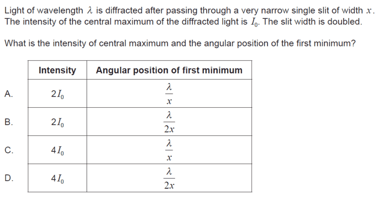

Please see below
θ = λ / b
I ∝ ##A^2##
My answer is (D) but the correct answer is (B). I thought the intensity will be 4 times since the slit width is doubled and amplitude becomes twice. What is my mistake?
Thanks
Area of the slit is doubled. If pinhole, the area is enlarged 4 times as your speculation.
I'm inclined to agree with your reasoning and answer.

The ##I_0## in the formula is not the "incident intensity". That is, ##I_0## is not the intensity of the light that is incident on the slit. ##I_0## represents the intensity at the center of the central peak of the diffraction pattern. ##I_0## will depend on the slit width. I agree with @songoku and @vela that doubling the slit width doubles the amplitude of the light at the center of the central peak. Thus, ##I_0## will quadruple.
[Edit: This assumes that we are dealing with "Fraunhofer diffraction" so that the formula ##I = I_0 [\frac {\sin \alpha}{\alpha}]^2## is applicable. Otherwise, it gets much more complicated.]

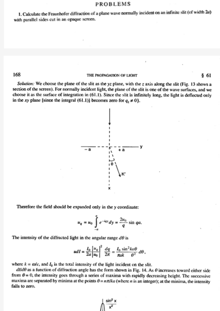

In seciton 61 of Classical Theory of Fields by Landau and Lifshitz
where I supose LHS of the last formula udI is a typo which should be dI. RHS is different by factor ##ak/\pi## from the web author's, where a is slit width and k is wavenumber of light. The intensity is proportional to slit width. Multiplication factor is, as an examle,
[tex]\frac{I_{max}}{I_{incident}}=\frac{2a}{\lambda}=\frac{0.05mm}{500nm}=100[/tex]
anuttarasammyak said:
In seciton 61 of Classical Theory of Fields by Landau and Lifshitz... RHS is different by factor ##ak/\pi## from the web author's, where a is slit width and k is wavenumber of light. The intensity is proportional to slit width.
Landau and Lifshitz's formula for an infinitely long slit: $$dI = \frac {I_0}{\pi a k} \frac {\sin^2 ka\theta}{\theta^2} d \theta$$
The LHS of the equation, ##dI##, represents the "intensity of the diffracted light in angular range ##d \theta##". I believe this is to be interpreted as the energy per unit time that is diffracted into the angular range ##d\theta## by a unit length of the infinitely long slit. So, ##dI## has the dimensions of power per unit length of the slit.
Landau and Lifshitz (LL) define the symbol ##I_0## on the RHS as the "total intensity of the light incident on the slit". By dimensional analysis of the equation, you can check that ##I_0## has the same dimensions as ##dI##. So, I think ##I_0## must represent the total power incident on a unit length of the slit. If we let ##\mathscr{I}_0## denote the usual meaning of incident intensity as power per unit area incident on the slit, then ##I_0## in the LL equation is ##I_0 =\mathscr{I}_0 \, 2a##, where ##2a## is the width of the slit.
Thus, if we express the LL formula in terms of the incident intensity ##\mathscr{I}_0##, it reads $$dI = \frac {\mathscr{I}_0 \, 2a}{\pi a k} \frac {\sin^2 ka\theta}{\theta^2} d \theta =\frac {(2 a)^2 k \mathscr{I}_0 }{2\pi} \left( \frac {\sin ka\theta}{ka\theta}\right)^2 d \theta$$.
For ##\theta \rightarrow 0##, this gives $$dI = \frac {(2 a)^2 k}{2\pi} \mathscr{I}_0 \,d\theta$$ So, doubling the slit width ##2a## for fixed incident intensity ##\mathscr{I}_0##, will quadruple the intensity at the center of the central maximum. This is in agreement with other textbooks.
I could be wrong in my interpretation of the symbols in the LL equation. So, I welcome corrections.
