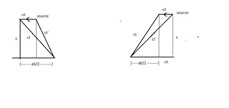

  • #124
OK,,,
consider the last diagram post in 88, and the attached diagram ( the left hand diagram is for slit A and the right hand is for B)
The source is also moving relative to the slit-FOR with -vt`
(cta`)^2 = s^2 + (ab`/2 - vt`)^2
(ctb`)^2 = s^2 + (ab`/2 + vt`)^2
where ta`and tb` are the time received by A and B relative to slit observer
after some transformation the quadratic equation yields the value of ta` and tb` as follow:
ta`= -ab` v +/- √[(ab`v )^2 + 4 (c^2-v^2)( s^2 + (ab`/2)^2] / 2(c^2-v^2)
tb`= +ab` v +/- √[(ab`v )^2 + 4 (c^2-v^2)( s^2 + (ab`/2)^2] / 2(c^2-v^2)
So clearly the s will disappear from the difference as you said,,,
But still the time difference Δt` = ab`v/(c^2-v^2) = ab`v/c^2 / 1-v^2/c^2
But for LT , Δt`= abv/c^2 / √(1 - v^2/c^2)
sorry for the bad shape,,, again you are right that s will disappear but still there is a difference

  • #125
I got it :
Still ab` should be transformed also according to LT and the final time difference will be the same Δt`= abv/c^2 / √(1 - v^2/c^2)
Final i suppose :)
  • #126
in conclusion:
1) The time difference between 2 slits is the same as measured by LT where no s appears
2) The phase is the same at A & B
Oh at last it becomes clear,,, thanks DaleSpam for inspiration
But Still I believe QM has a different opinion
I appreciate your comment please on my calculation ( although on bad shape)

You are welcome! The set up equations look good, but the follow up calculations got too messy to follow on my mobile device. But the conclusion is reasonable, so I have no reason to doubt the intermediate steps.
