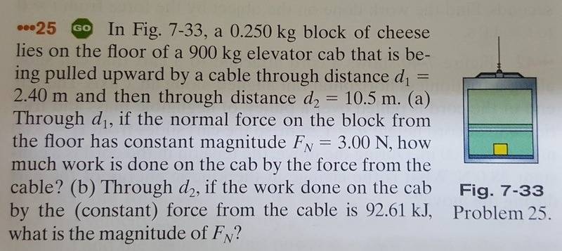

This is the question from Halliday. I have solved this problem and checked the answer from my reference
which started its statement with below
F + Fn − (m + M)g = (m + M)a
where m = 0.250 kg is the mass of the cheese, M = 900 kg is the mass of the elevator cab,
F is the force from the cable, and 3.00 N, Fn = is the normal force on the cheese.
And I think this explanation is wrong
Shouldn't it be F - (m+M)g = (m+M)a ?
Cuz what I think is
for elevator) F-Mg-Fn=Ma (i)
for cheese ) Fn-mg=ma (ii)
(i)+(ii) -> F - (m+M)g = (m+M)a
If I am wrong, please tell me what is my error.
