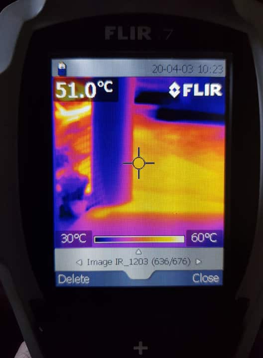

It took me an hour to do the tests above. This is because the imager is very sensitive (it can for example image the left over heat from the floor of the feet, etc.). As soon as I put my hand in the sun, the temperature increases very fast from the heat of the sun (2 seconds later). So I have to take many shots, and since the reading varies by each spot of the hands, I have to fix it at one spot. I managed to take one good shot. The effect is either only 0.1 degree Celsius or similar.
This is in the parking with the sun in the heated part of the pavement:

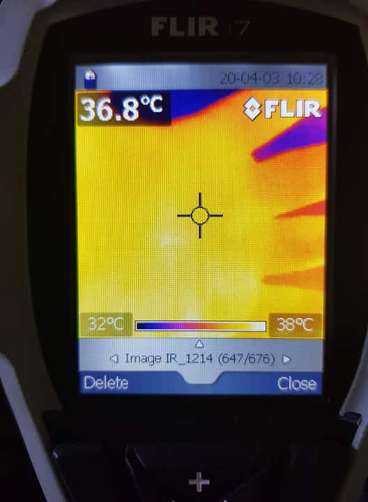

This is taking it in the shade.

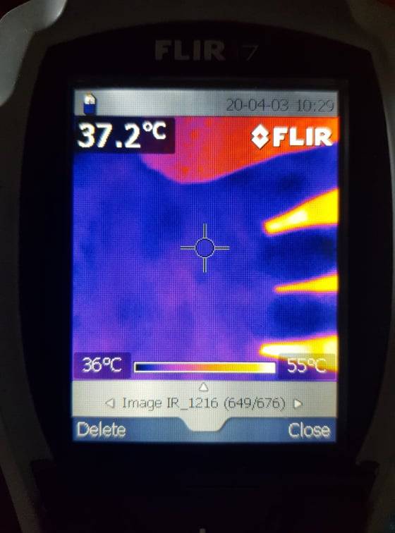

This is when I put my hand in the heated area of the parking.

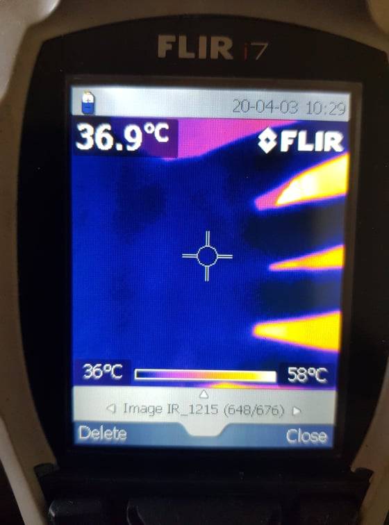

Difference of only 0.1 degree Celsius. And 1 or 2 seconds later, the temperature begins to increase due to the heat of the sun.
The imager is set to 0.98 emissivity with reflected temperature of 20 degree Celsius.
I think putting the values in the imager firmware means it has to subtract 2% of the software "reflection temperature" of 20 degree Celsius from the raw image it's taking? I wonder what is the temperature of the sun's rays? How do you determine the temperature of the sun's rays? And if it is high or a given value. You compute it by taking say 36 Celsius (actual) minus 20 Celsius (software setting) = 16 Celsius and taking off 2% of 16 Celsius deducting from the raw image temperature? How do you compute it?
I also tried putting my hands or fingers in the refrigerator. But the temperature decreases so suddenly (in milliseconds) I couldn't distinguish the reflected temperature from absorbed temperature. The imager is too sensitive in the freezer test to produce any useful data.
