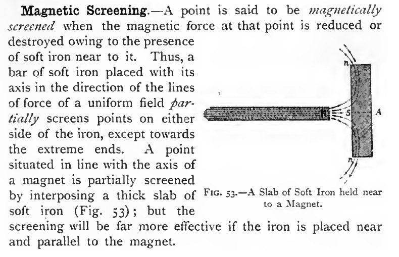

I can send you a scan from a book of physics where this is stated. But I don't know how to upload pictures (or PDFs) here.
You should be able to click the "Upload" button at the bottom right and attach a file or picture.
Ok, I attached it.

I don't think that this is an accurate description of what high permeability means. If a material has high permeability then it becomes highly magnetized in response to an external field. The result of that would probably be better characterized by saying that it pulls magnetic field lines into itself.
A big plate of iron placed in front of a bar magnet (plate area say 100 times that of the pole of a magnet) reduces the magnetic field behind it.
If the iron plate became highly magnetized in response to the field of the bar magnet, it wouldn't have this effect, the plate would develop an equal pole on the other side of it and transmit the field to its rear. So rather than saying it pulls the field lined to itself, it looks like iron really prevents the lines from passing through.
That's not how it works. To shield a point, a sensor, say, place your iron sheet near the sensor but parallel (not perpendicular) to the field lines. The field is pulled into the iron as Dale said and conducted along it. This reduces the field at the sensor.

Ok, but from the figure attached, it seems that the iron rather blocks the magnetic field than transmitting it. Hence probably iron shouldn't be described as having high "magnetic permeability", on the contrary, it has low "permeability" since it blocks the magnetic field. Compare it to a plate of wood of identical dimensions, where the magnetic fields passes through easily.

Ok, I see the difference. But, I find it quite strange to call iron "high permeability" material and not to have a strong magnetic field on the back of an iron plate right opposite the pole of a magnet. Rather I suspect something similar with a superconductor might be taking place: lines enter the iron superficially and then travel along the surface - while for a superconductor the lines do not enter at all.

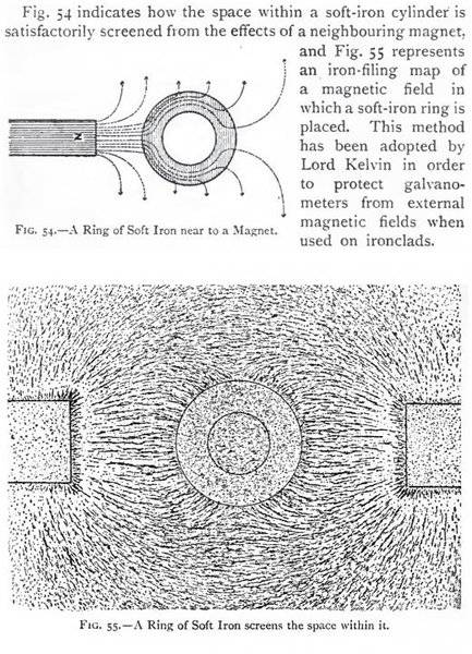

Completely wrong. Field lines are conducted ("permeate") into the the bulk of the iron, and flow through it. Looking at conceptual drawings like the one you showed and the one I linked to can be misleading. If you look at a proper numerical simulation of the fields, you'll see more clearly. Here are field lines incident on a hollow ferromagnetic cylinder. You can see field lines "attracted" to the iron and conducted along it at top and bottom. The fields completely penetrate the material. Notice also that the left and right sides of the cylinder, which are normal to the field, do not block field lines at all. All the action occurs parallel to, not normal to, the fields.
http://www.magneticshields.co.uk/en/technical/magnetic-shielding-how-does-it-work

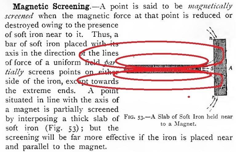

Maybe a picture will help.
First thing to straighten out is magnetic flux , like current, makes its way back to the source. Think "Closed Loops".So in OP's first picture
here's what i would add to hopefully resolve the misunderstanding.
Flux (in red) will prefer the permeable iron slab , not the impermeable air behind it. (well, permeability of just 0.00000126)
That image in MarcusL's post 14 is just great , shows how an iron pipe routes flux around its hollow middle. That's why we use iron conduit for some sensitive signal wires in the power plant.
Thanks for taking the time to draw the magnetic lines in red. But I go back to my initial point and say you don't have any experimental proof that the lines actually go so deep in the iron plate, I think they enter the plate (if at all) very superficially, most of the lines just glide past the surface (iron screens them), that's why the poles seen at the edges are towards the magnet side and not also to the rear side. Also I have a great deal of trouble understanding why a N pole is not induced at A on the plate since iron is such a "high permeability" material, which also tells me iron's screening is real and not due to "high permeability".
The iron pipe routing the flux around its hollow middle can be seen also as a proof that iron is not permeable to magnetism, thus prevents the magnetic field from passing through. If the pipe were made of plastic, that would be a "highly permeable" material to the magnetic field since it let's the magnetic field pass through.
