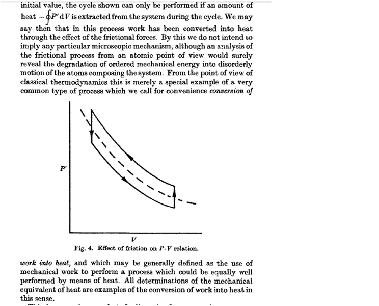

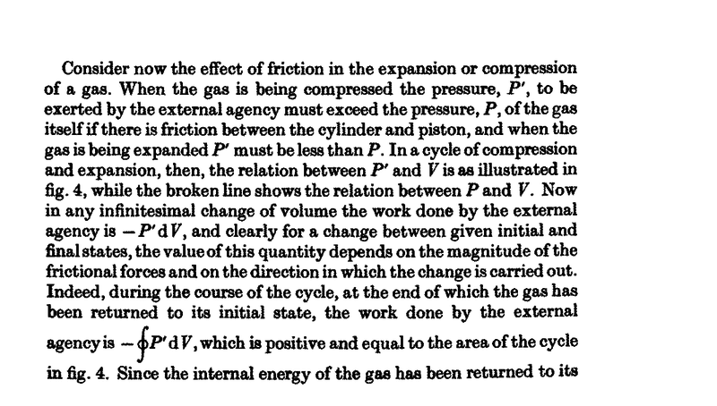

1) I am reading Pippard's Classical Thermodynamics and was confused by one of his examples in the attachment.
What I do not understand is the concept of using P' (I am thinking P' as = P_fric + P_interface) for work calculations. If I take the system as composed of just the gas inside the cylinder and assuming this system is insulated and the process quasistatic, pressure at the gas-piston interface should be equal (P_ interface) and the system only sees P_ interface applying work onto it during compressing and applying P_ interface during expansion. I get that P' is important because it includes friction, but the system/gas doesn't see this since it is happening outside its system boundaries.
2) For the same insulated piston cylinder system, if the compression-expansion process is quasistatic but the process contain irreversibilities like friction which is converted into heat and absorbed by the system since it is insulated, would first law become Qfric - W = E_2 - E_1 where W = P_ interfaceΔV and external applied pressure equal to P_interface + Pfriction?
I'm having trouble imagining how this system is irreversible since all of the applied energy in one form or another is added to the system; why wouldn't it be able to return to its initial state?
Thanks very much

Red_CCF said:
Hi
They're assuming that all the frictional heat goes into the gas. If this happens, then the approach of treating the gas as the system doesn't work because its temperature is affected by this heat.
No. It would become - W = E_2 - E_1 , where W=P'ΔV.
Thanks very much
If it's done isothermally, no problem. But, if it's done adiabatically (which apparently is the case they're looking at), the frictional work contributes increases in internal energy during both expansion and compression. So this can't be reversed.
Chet
The way I am imaging this, P' is applied to the piston, and the piston compresses the gas at P_int < P' and the rest used to overcome friction between the piston and cylinder wall outside the system (taking system as only gas). To me, the gas only sees P_int applied onto it and doesn't see P' or friction. What are other options for defining a system in this case where it would make sense to include P'? What happens if frictional heat is assumed to go elsewhere and not the gas?
Why is it incorrect to treat friction as a heat term and use W=P_intΔV; also does |P'ΔV| = |Qfric| + |P_intΔV|?
Thanks
You ask such good questions! The "system" they are using includes the piston (which is assumed to be massless, and to have zero heat capacity). Their analysis assumes that all the frictional heat goes into the gas.
If the frictional heat is assumed to go elsewhere and not the gas, then the problem reduces to your analysis (which, of course, for that case, is correct).
Thanks
You don't have direct access to Qfric. You don't even have direct access to (P' - P), unless you put a pressure gage inside the cylinder. It is, of course, possible to calculate P incrementally, driven by the work (P'-P)dV, and to solve for P along the path as well as for the incremental amounts of frictional heat along the path. But, this is not as convenient as just measuring P' and calculating the integral of P'dV. This will give you what you want much more easily. That's what they do in your book.
Chet
I was told to never include two separate components in one system which was why I never thought to include the piston; so the piston is basically a 'void' in the system that does nothing thermodynamically (i.e. work cannot be done by/onto it, change in its KE, PE is insignificant etc.)?
For irreversible, non-quasistatic processes, wouldn't the above imply that W = ∫P'dV? I've read for rreversible, non-quasistatic, internal gas pressure is usually undefined, and work does not equal to ∫PdV, even if it can be computed. Instead, from this post and this post (where the system appear to be gas only), work is compared to ∫PdV as an inequality, although I'm not sure which P is being used. My confusion is now basically which pressure is used in PdV calculations for irr. quasistatic and non-quasistatic cases (on the piston, inside, or outside of the gas-piston boundary), and if W = ∫P'dV is true for non-quasistatic cases, does this contradict two posts I mentioned above.
If friction goes elsewhere, the system would be the gas and W = ∫P_interfacedV = E_2 - E_1? Would this case still be irreversible as friction existed in the process but outside the system?Thanks very much
Yes, if the system as taken as the gas plus piston (as your book does).
I think that all this can be cleared up for you by reading my 2 page Blog at my personal PF area. But, in summary, what you said is correct: W = ∫P'dV applies both to reversible and irreversible processes (if P' is taken as the force per unit area at the interface between the system and surroundings). It's just that, in a reversible process, P = P' everywhere throughout the system.
If friction (heat) goes elsewhere, the system would be the gas and W = ∫P_interfacedV = E_2 - E_1?
Yes. If you chose the gas as your system and the deformation were quasistatic, this would be correct.
No. For the gas as the system, the process would be reversible.
Chet
