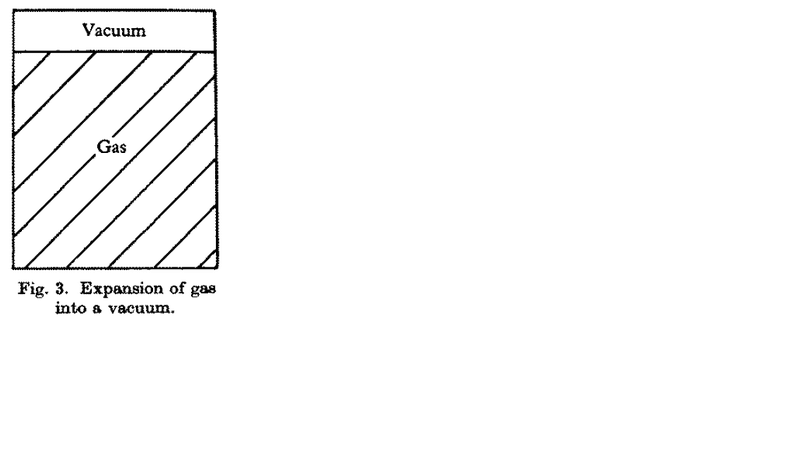

Let's come back to this after we do the case of finite piston mass.
a) For the gas+piston combined system, W = 0 since P_ext = 0
Correct.
b) For the work the gas does on the piston, I am tempted to say that W = 0 and PI = 0, but am not confident in this. I think at the beginning of the process an infinitesimal pressure difference will occur between the two sides of the piston just to get it moving, and I'm not sure if the inertia of the piston will hinder the expansion process if it is moving slower than required for PI to be 0.
All these uncertainties can be cleared up by applying Newton's second law to the piston. Let PI be the (unknown) gas pressure on the left side of the piston and let A be the area of the piston. Let m be the mass of the piston, and let x be the displacement of the piston to the right relative to its initial location when the original constraint on the piston is removed. Write out Newton's second law, and we will be able to continue from there.
Chet

F(t) = mpistona = PI(t)Apiston
dW(t) = PI(t)A*dx
Is the above correct?
Red_CCF said:
dW(t) = PI(t)A*dx
Yes, so far. The acceleration can be expressed in terms of x as d2x/dt2. So:
[tex]m\frac{d^2x}{dt^2}=P_IA[/tex]
If we multiply both sides of this equation by dx/dt, and integrate with respect to time, we get:
[tex]W(t)=\frac{1}{2}mv^2(t)[/tex]
where W(t) is the work done by the gas on the piston up to time t, v(t) = dx/dt, and the right hand side is recognized as the kinetic energy of the piston.
Here are some questions to consider:
What happens when the piston collides with the far end of the cylinder (if the collision is elastic)? Does the piston keep moving forever (even if the piston is frictionless)? If the frictionless piston eventually stops, what causes it to slow down and stop?
Chet

Red_CCF said:
I got a little mixed up, how did you go from the first to the second equation?
Multiply both sides by dx/dt:
[tex]m\frac{dx}{dt}\frac{d^2x}{dt^2}=P_IA\frac{dx}{dt}[/tex]
Substitute v for dx/dt on the left side of the equation and dV/dt = Adx/dt on the right side of the equation:
[tex]mv\frac{dv}{dt}=P_I\frac{dV}{dt}[/tex]
Now, integrate with respect to t:
[tex]\frac{m}{2}v^2(t)=\int{P_IdV}[/tex]
Also, for this integral to work one has to assume that a and PI are non-zero for at least some time during the time interval; how is this known?
For the case of a piston with mass, PI is never going to be zero. The gas is always going to be accelerating the piston toward the far end of the cylinder.
If the piston collides at at the end of the cylinder, I would assume that some energy is transferred to the cylinder even if the collision is elastic (i.e. if the cylinder was on a frictionless surface it would gain kinetic energy).
No. The cylinder is assumed to be anchored to the lab, so, in an elastic collision, the piston retains all its kinetic energy, and its velocity simply reverses sign.
If there are no irreversibilities within the gas itself, I think the piston would initially move back until the gas pressure slows it down and pushes it towards the far wall again, and this behaviour should oscillate with decreasing range of motion for the piston. I think this behaviour would continue as t → ∞, so maybe the piston never stops?
Thanks very much
By "irreversibilities within the gas," I assume you mean viscous dissipation. Without viscous dissipation, the cylinder and the gas would continue moving back and forth forever, interchanging compression with kinetic energy. In our case, the air within the cylinder does have viscosity, and eventually, the piston velocity will slow down to zero, and the piston will come to rest at the far end of the cylinder. This will be the condition of our system at final steady state. We already said earlier this when we analyzed the problem taking the combination of the piston and the gas as our system.
So, in our adiabatic irreversible problem, we now know that the work done by the gas on the piston is zero, and the heat transferred is zero, so the change in internal energy is zero, and the change in temperature is therefore also zero. So, even in the case of a finite mass for the piston, we still get the same answer.
Chet

This is from Pippard's Classical Thermodynamics (figure attached) at the end of his development of the TdS equations
... illustrated by the experiment pictured in fig 3., the expansion of gas into a vacuum under isolated conditions. Here PdV has a definite, non-zero value, but w = 0; similarly q = 0 but TdS has a non-zero value, which could be determined by compressing the gas reversibly to its initial state and determining how much heat must be extracted during the compression. We should find that it is just equal to PdV, and that in consequence the entropy increase during the irreversible expansion was PdV/T.
However the wiki article on free expansion appear to agree with you:
A free expansion is typically achieved by opening a stopcock that allows the gas to expand into a vacuum. Although it would be difficult to achieve in reality, it is instructive to imagine a free expanion caused by moving a piston faster than virtually any atom. No work is done because there is no pressure on the piston. No heat energy leaves or enters the piston. Nevertheless, there is an entropy change, and the well-known formula for entropy change,
Thanks very much
Sorry the figure is attached to this post.
What he's saying (rather poorly and ambiguously) is: If we integrate pdV using p and V from the ideal gas law, we get a definite value for the integral, but it bears no relation to the work done in free expansion (which is zero). The integral of pdV only gives the correct value for the work W if the process is reversible.
The wiki article is clearer, but there is still a problem with what they say. If the gas is released through a stopcock, then there is a pressure drop across the stopcock, and this does not constitute free expansion. In order to have free expansion, there can't be any resistance to the gas expanding. There have been several threads in Physics Forums recently in which we have worked problems involving a high pressure gas passing through a valve into a lower pressure container until the pressures in the two containers equilibrate. Even if the initial pressure in the low pressure container is zero (pure vacuum), this is not free expansion.

For irreversible processes (like the free expansion process), what would the P calculated from ideal gas law represent; is it some averaged pressure term for the whole system? My current impression is that this P term is more specific than what we are discussing, which is a general stress term σI specific to the system interface?
Below is from the same paragraph from Pippard as I posted earlier
It is only for a reversible change, however, that q = TdS and w = -pdV; neither of these equalities hold for an irreversible change - q ≠ TdS and w ≠ -pdV - but dU = TdS - pdV is still valid; if q = TdS - ε then w = -pdV + ε. This point is illustrated ... [rest of the paragraph on the free expansion example posted earlier]
Do you happen to know what he means by the bolded and why it is true?
In an irreversible process, the pressure and the temperature are both functions of position (at a given time), there is probably not just one unique average temperature and average pressure for the system that also satisfy the ideal gas law. Even if we mathematically define average pressure and temperature in such a way that the ideal gas law is satisfied, it is unlikely that these values will have any physical relevance, and they couldn't be used to correctly calculate the amount of work that is done. So, what good is that.
